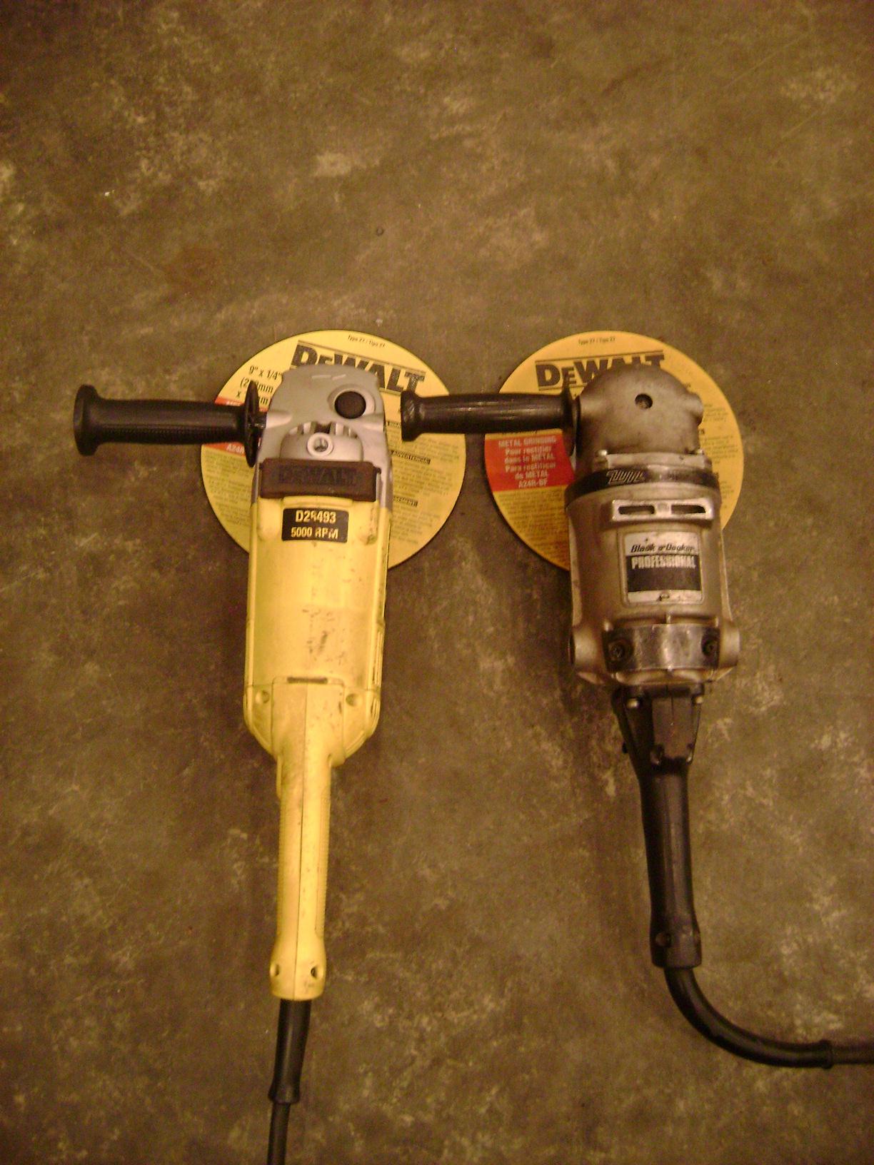

I just re-checked the specs on 3 of my non-HF grinders
The 4.5" milwaukee is 10a and 10k rpm. (earlier I mentioned 11a and Iw as wrong)
The 5" hilti is 8.5a and runs at 11k rpm and not 9a I mentioned earlier
The 6" metabo is indeed 12.2a, and has a variable speed wheel with a max of 10.5k rpm
Changing that to surface speed, the 4.5" milwaukee is the slowest.
milwaukee 10k rpm @ 4.5" = 11,775 SFM
Hilti 11k rpm @ 5" = 14,391 SFM
Metabo 10.5k rpm @ 6" = 16,485 SFM
Not a noticable difference in weight oer heft in any of them. But they are noticeably heavier and longer than the HF 4-6a ones I have. Truth be told, my method for picking a grinder out of the drawer has more to do with whats already on it than what brand, speed, or power it is. I do grab the 6" if I need to run a big cut disc to get into a tight area.
Here is a side by side. Dont pay attention to the missing guards. I was too lazy to put them back on. Usually dont use them when running a flapper or wire cup. Only if running a stone or zip disc.
