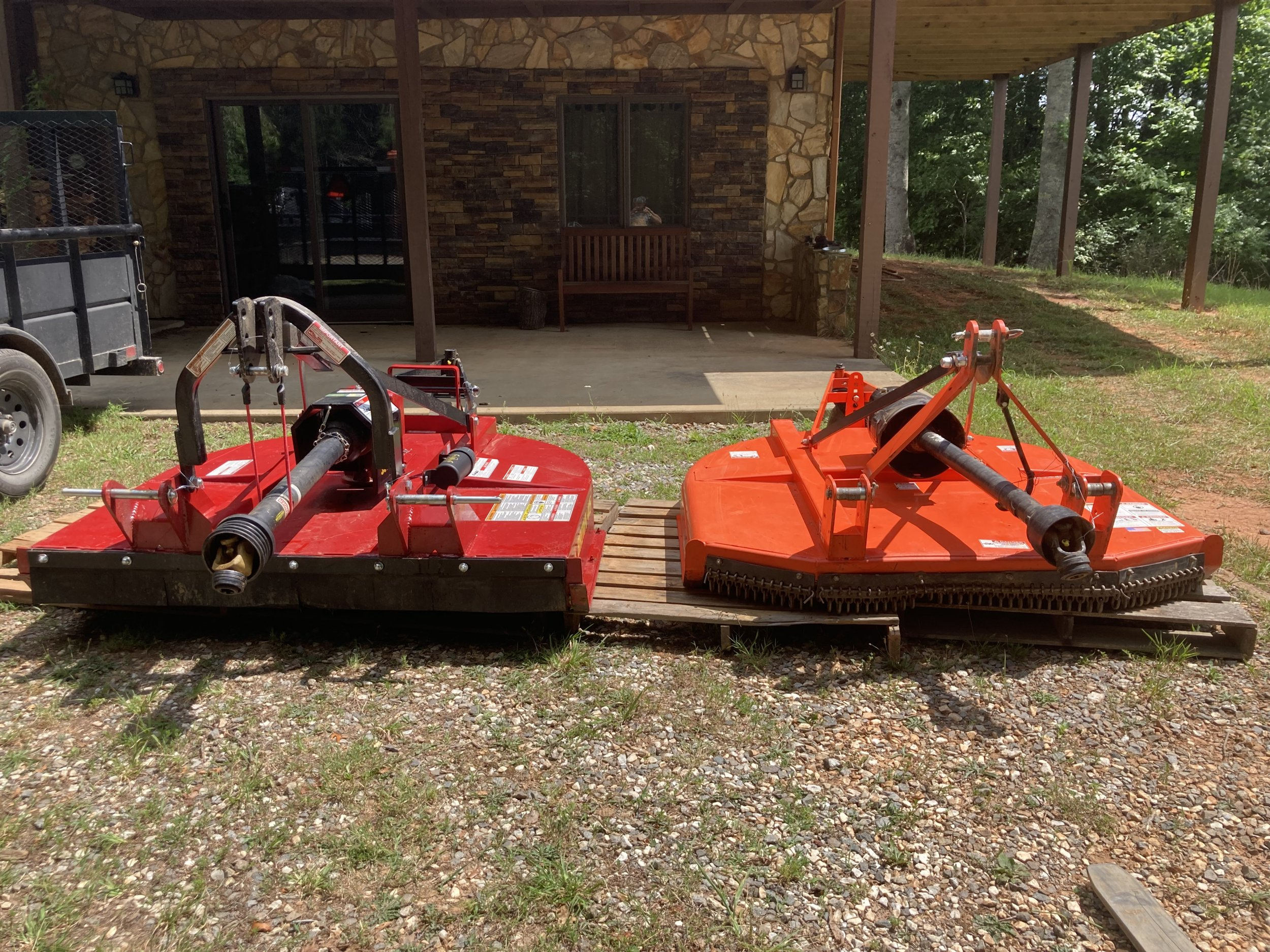

Get a Brown 415 it’s the heaviest duty that size tractor can run. With chains it’s around $4200 plus tax. Side by side with a RCR 1860 there is little comparison
