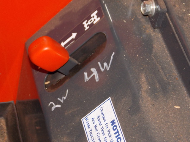

Great idea and nice job. With my old eyes, and using low-tech methods, I did this on my B3030. I noticed that the 4-wheel lever on the B3030 is opposite of the BX25.
