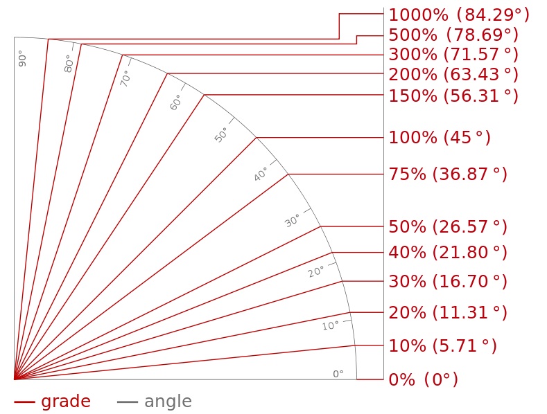

Probably means 35%. A 35 degree slope is over 70% and you are not going up or down a 70% slope on any wheeled vehicle.
   / 4X4 downhill traction issue #137
Click on the picture of him on the mower. It is 35*.
   / 4X4 downhill traction issue #138
   / 4X4 downhill traction issue #139
Yep, that's the right chart. If you double click on it, it will come up in a size you can see/read the numbers. The 35 or 40% slopes are quite tractable for wheel vehicles. The 35 degree (over 70%) slopes are not feasible.
#140
Hey JWR,come on over.Another 30ft back it goes up to 40 deg and a lot farther to the bottom.We'll have some real fun then..:eek:
