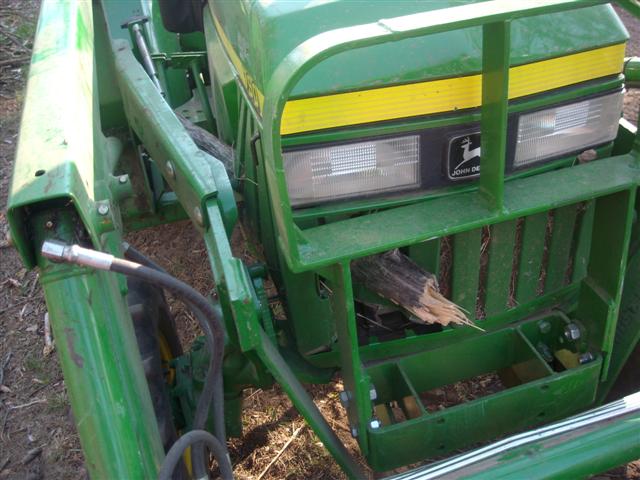

I agree the price for this attachment is pretty high. BUT WORSE is that it doesn't do a very good job of protecting the grill / radiator. I believe the 4x20's and 3x20's are the same guards.
My used tractor (3320) came with the "heavy duty" brush guard.....but note the gaping hole which could prove fatal in brush. I added a metal plate to complete the job as shown in the pics below (which I think Deere should provide).
If I were buying new....I would get the light duty guard....and modify it to protect my grill. Its expensive to lance your grille. Pay now.....or pay later. ;)
Oh....and I wouldnt be too quick to count your profits from the AM guard biz. I offered the plate shown for about $30.....and didn't have a single taker. Guess I'm the only one sees a problem here. (grin)

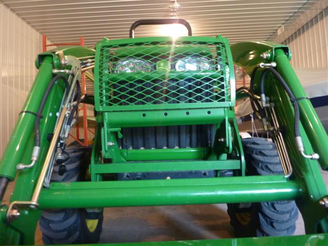

As far as I can tell, the delux guard is nothing more than some expanded metal in a frame and side wings added to the standard guard. I already have the standard guard.
You are correct....and I believe that you can add the guard with a few bolts and a few minutes time. The deluxe (HD) guard is none too stout IMO. I worry that one could easily pierce or otherwise tear the expanded metal (or welds) with a stout branch.

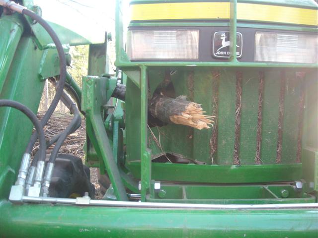

Here's why you should worry too......;) My old 790 BEFORE I improved the guard. You have been warned! :laughing: And, note the "improved" version in the last pic. Who sez I cannot lern? ;)

OH....and notice how vulnerable those hydraulic lines are in the pics above? Newer models are slightly better protected....but improvements can be made for a few bucks and some time. It's not so much a cost factor as it is being down when you need the tractor. It really ruins your day when you break a hose or line on a Saturday afternoon. Dont ask me how I know. :(
