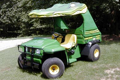

just saw this thread and was ready to reply "no fuse box and replace the battery". Sorry didn't see it when you posted.
Glad it is fixed, and I have the 4x2 Gator and replaced the battery two years ago.
Since '99, it has been one fine running machine. Pride of the grand kids (and me :D).
