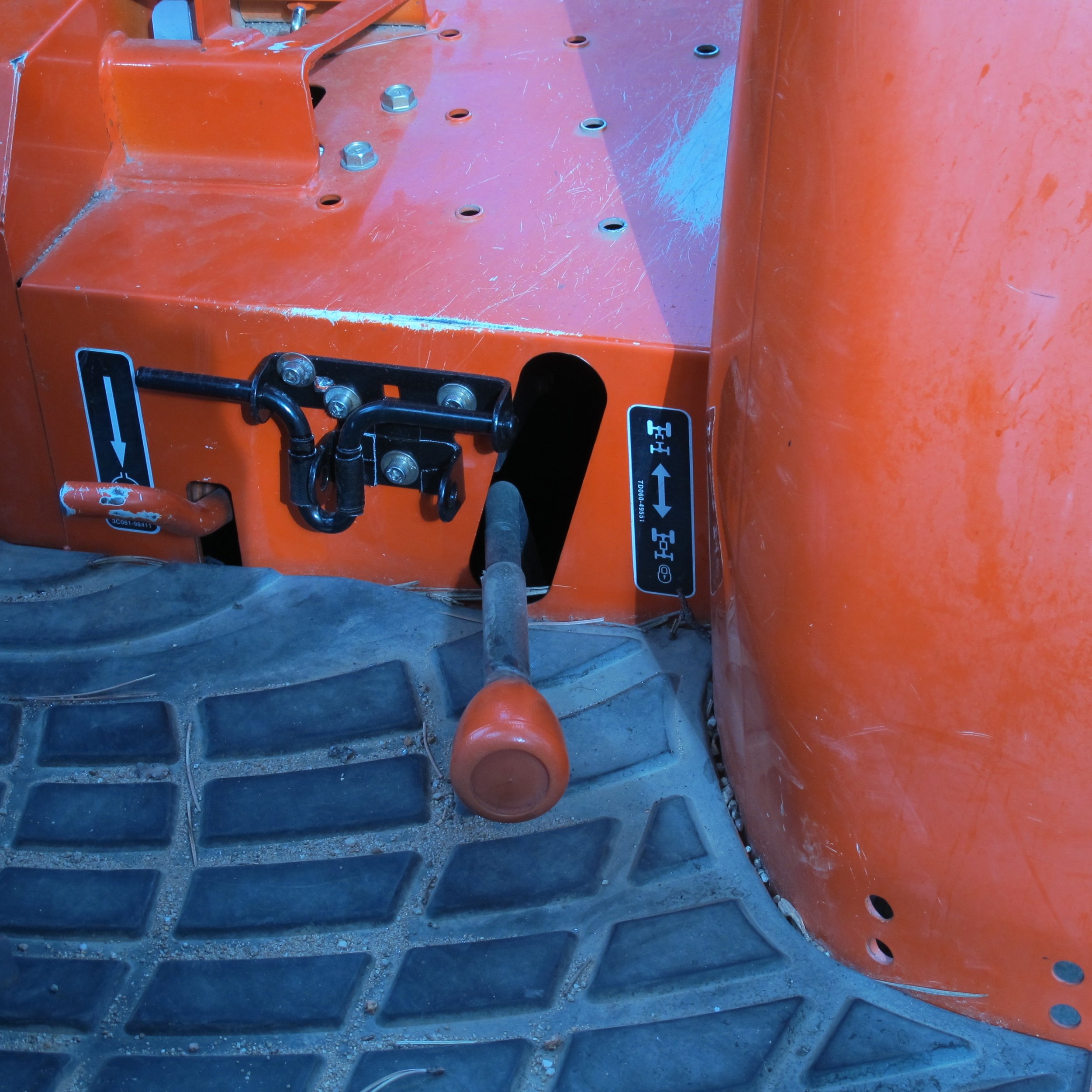

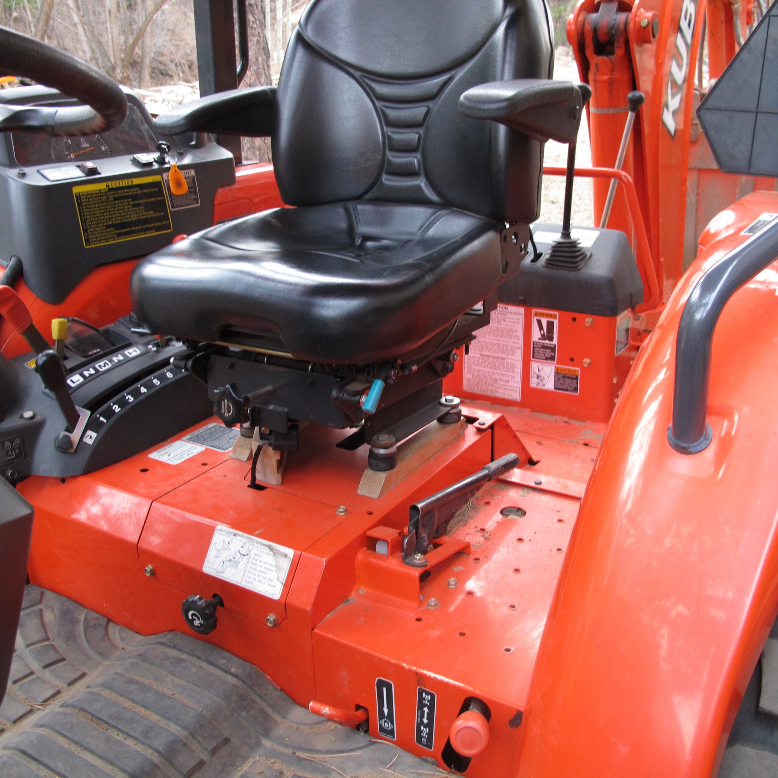

The first photo shows the tractor as it was new.... The problem I had with the 4wd lever was it kept being engaged by accident getting on and of the tractor. The solution was to mount the black gate latch you see in the photo.

Think of it this way: Most of the time you will be in 2wd. These tractors are 4wd assist; NOT full time 4wd. Compact and Utility size tractors under about 90 hp don't have a center differential, which means that the only way they have of getting rid of the built in "wind up" that happens to the drivetrain in 4wd is to slip a wheel.
Use 4wd when needed, and once through the rough spot put it back into 2wd. You can get by with leaving them in 4wd in slippery conditions if you are careful and especially without a FEL. Basically as long as a tire can easily slip, you are OK.
That's why the gate latch in the photo. It isn't to keep it in 4wd, a bit of unavoidable shaft windup will do that for you. The latch is keep something - like my heel - from knocking it into 4wd when it shouldn't be. Like when I'm traveling with a load in the FEL.
