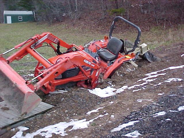

Doesn't seem like chains would have helped this guy though...see attachment...sorry, I don't remember who this was...
