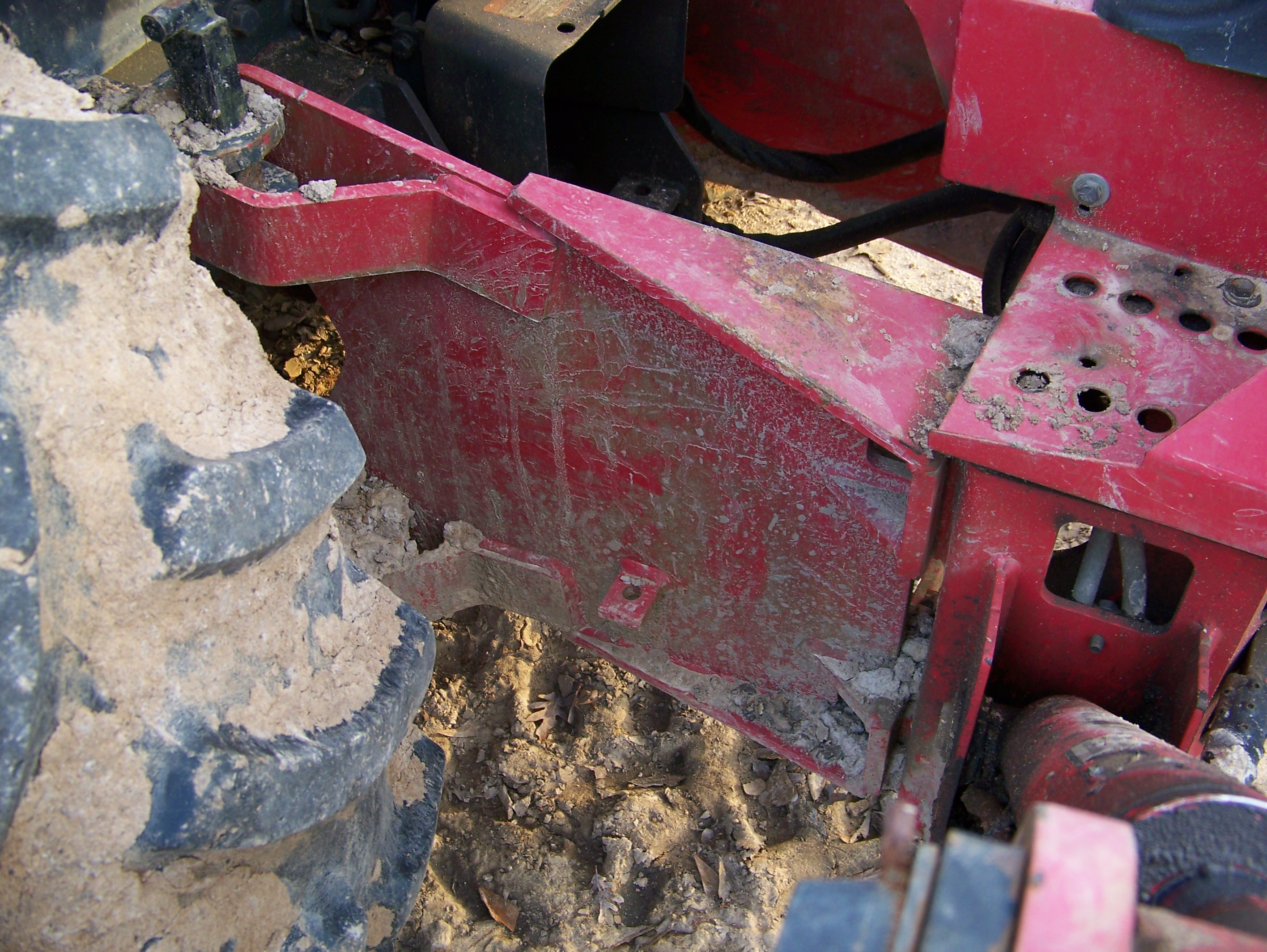

The tractor side of the mount is 5/8". Nothing moves when I pick the tractor up, but if I hook a stump and pull hard, I can get the tiniest bit of movement at the upper mount. So far as I can tell, it's because the 1/2" x 4" stiffener plates that go up to the FEL mounts are deflecting just a little. If I end up breaking them, I'll go up to 3/4" when I remake it, and extend the 3/4" thick part a little farther forward. That should stiffen everything up quite nicely. But I really doubt I'll ever manage to break it... :)
My mistake. Mine is 1/2" with 1/2" gussets running all the way forward up to where the upper mount, which is two...1/2" plates. It really looks like an I beam.
hugs, Brandi

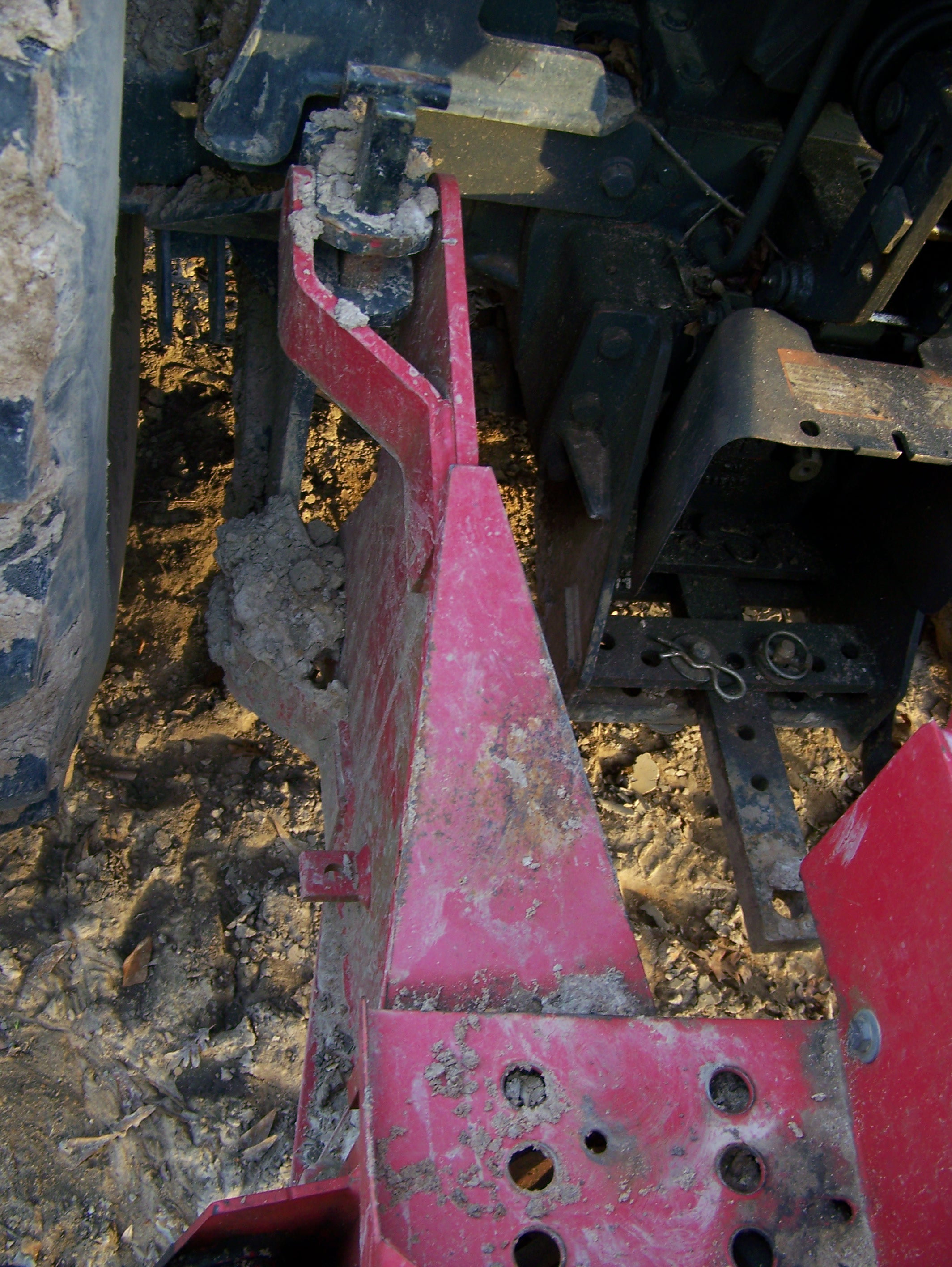

I was talking about the backhoe half. My tractor half is 1 inch think. Here are photos of my backhoe half with the gussets on top and bottom. Backhoe Subframe.jpgBackhoe Subframe Top View.jpg
hugs, Brandi
