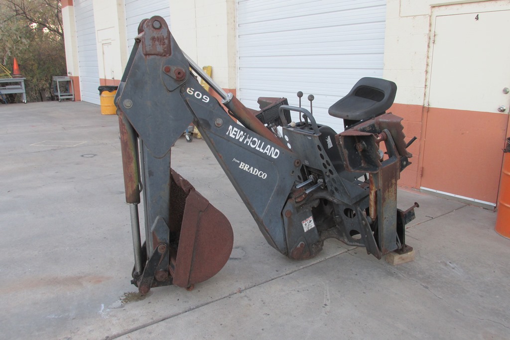

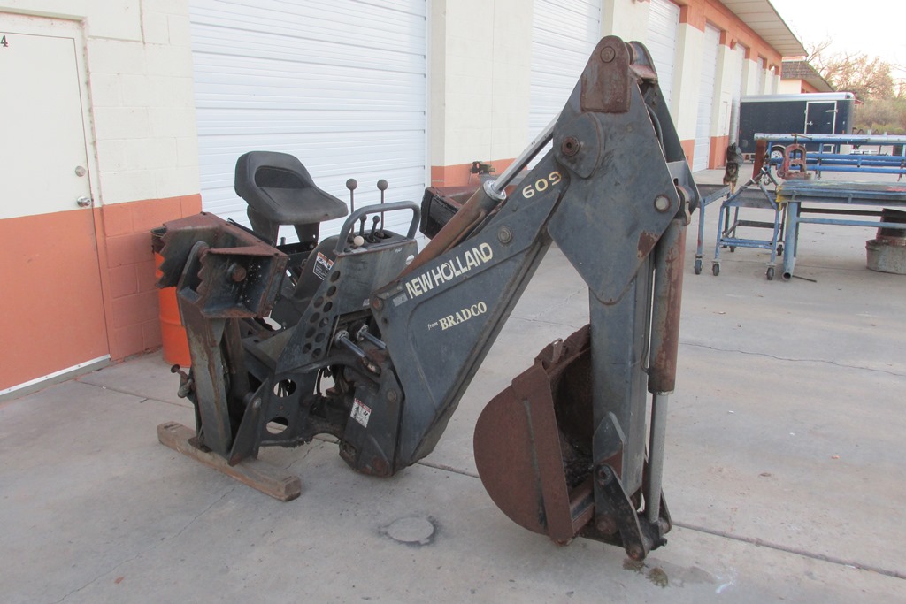

Well, it's done, so I thought I'd post a thread. I wanted a BH for my tractor, and wanted something fairly powerful, since we have a lot of clay where we're building. I ended up finding a Bradco 609 in Florida for a good price, and had it shipped to me for less than I'd seen anything semi-local. It's not perfect, but it's powerful, and it's all there.

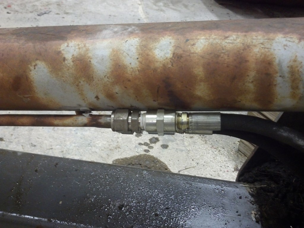

Right away after getting the hydraulics plumbed in on my tractor and hooking them to the BH, I discovered that that cylinder fittings on both stabilizers had rotted off the tube they were welded to, and would spray hydraulic fluid out instead of extending the ram...
I opted to cut the tubes back and clean them, then use some crimp-on style fittings. Parker calls them Ferulok, but I think the ones I used this time were from another supplier. Same but different... Unfortunately, they only offered them in pipe, and the local shop didn't have a pipe to JIC adapter, so I had to go with pipe on one end of the new hoses instead of my preference to always use to JIC on both ends.

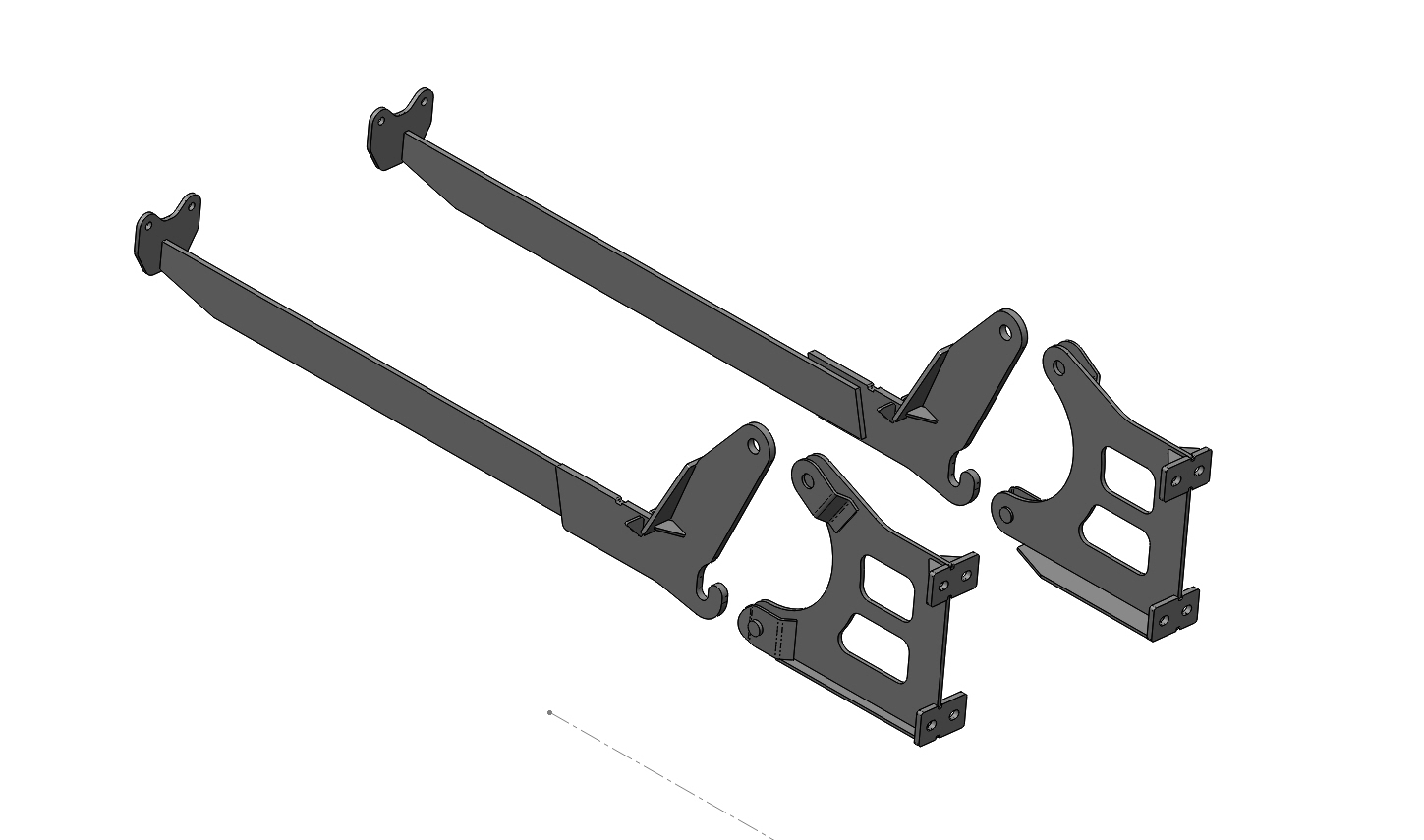

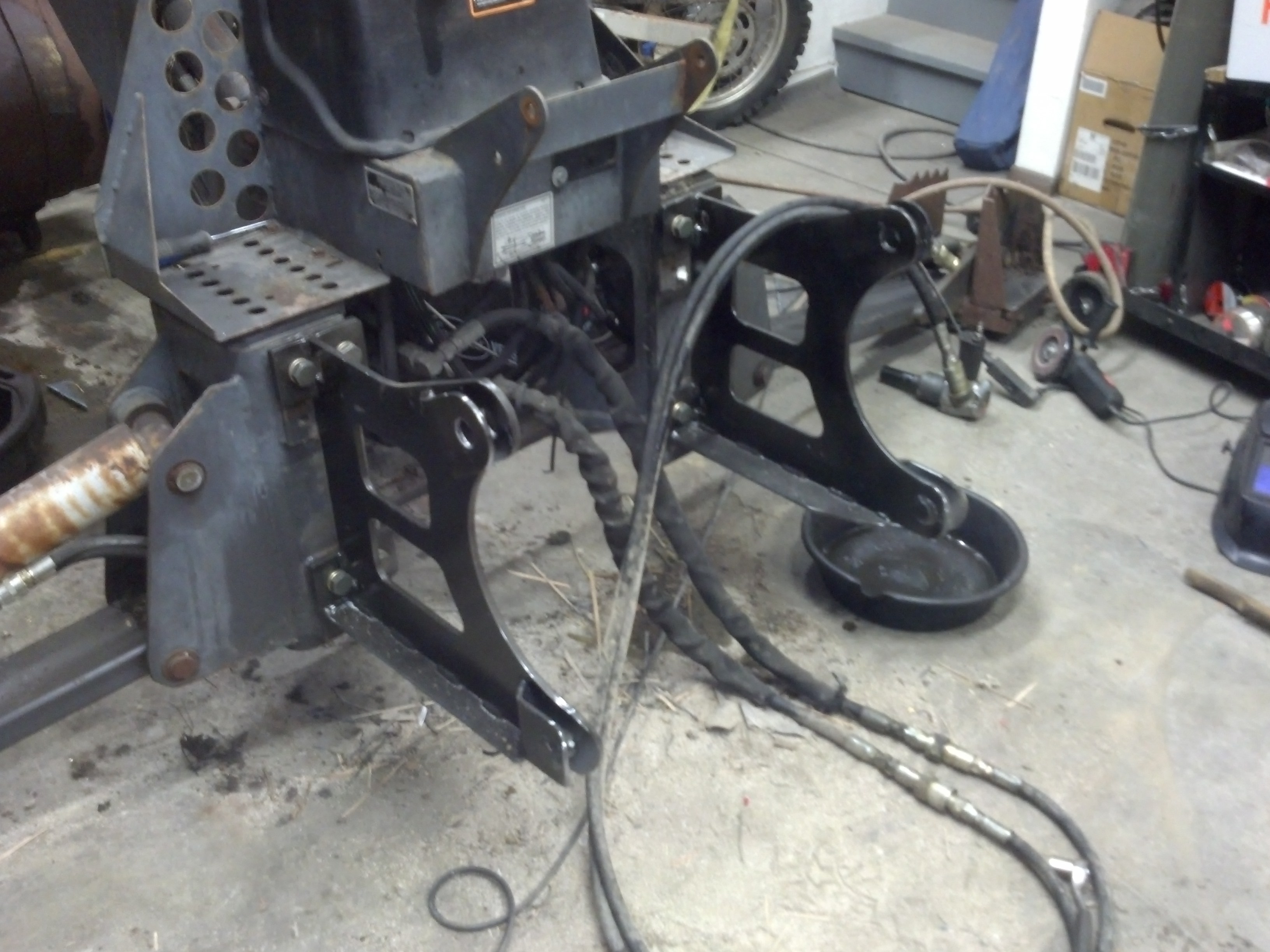

How to mount it?? I contacted Bradco, but they didn't offer a mount kit for my tractor. We thought the one for the previous gen might work, but it was going to be ~$1200 for the system... I surfed around on TBN and looked at some mount styles, and visited the Kubota and LS dealer to look at theirs. Came to the conclusion that a 4pt mount was indeed ideal. Bradco was nice enough to send the instructions for the mount they thought might work, and I used the illustrations of their setup as my inspiration to design my mount in CAD.

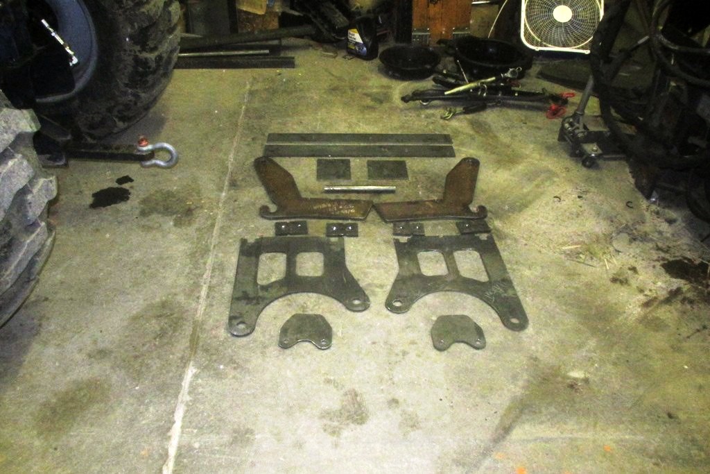

The tractor side is 5/8" plate, welded to 1/2" plate braces that bolt to the loader mount. The backhoe side is 3/8" plate, with 1/2" plate bolt tabs and 1/4" lower stiffeners and double shear tabs. 1.25" Cold Rolled round for the upper and lower pins, with the lowers being welded into the BH mount. The holes on the BH plates were just for show, and because the thing already weighs ~1750lbs...

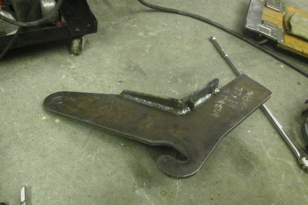

I had a local place cut the BH and loader bolt plates, and both parts of the 4pt mount on their CNC plasma table. In hindsight, I should have asked for the tractor plates to be cut on the waterjet, as they would have been much cleaner, but were going to do it all on the waterjet for an extra $100, and I was being too cheap... I paid $440 for the plasma parts, and about $70 for the round and plate steel.

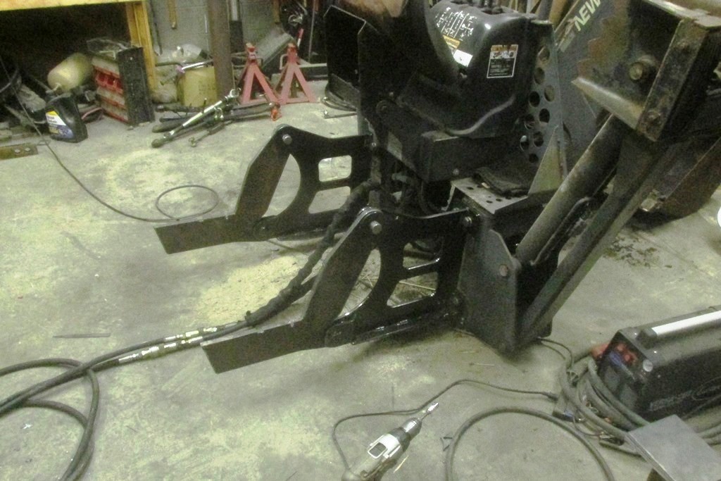

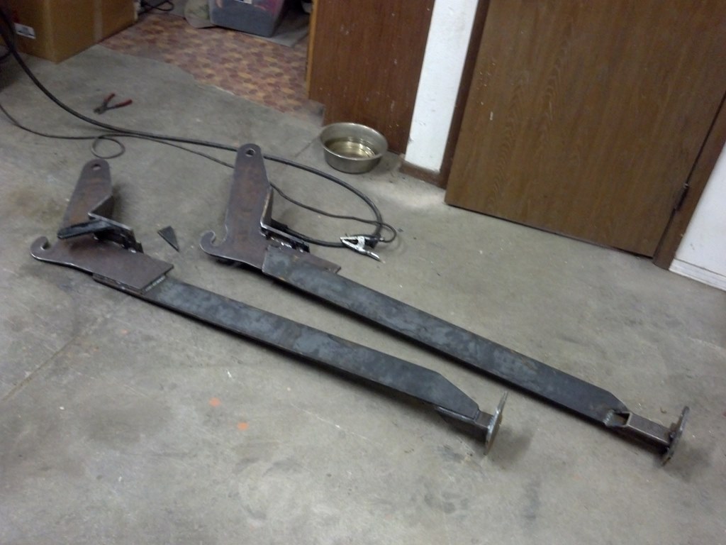

I first built the BH half of the mount, so I could use it to get the tractor plates to fit, and then for fixturing so I could weld the tractor side up... I got the tractor plates to fit the BH mount with some ambitious die grinder work...
I used the BH to position itself vertically, and backed the tractor around until it was all centered. Then I tack welded the 5/8" plates to the lower ROPS plates. Welded all that up off the tractor...
Then I bolted the welded parts back onto the tractor, and tacked the chassis stiffeners in place. I ended up using a bit of 2x3/16" square tube at the front to get it to fit a little better...

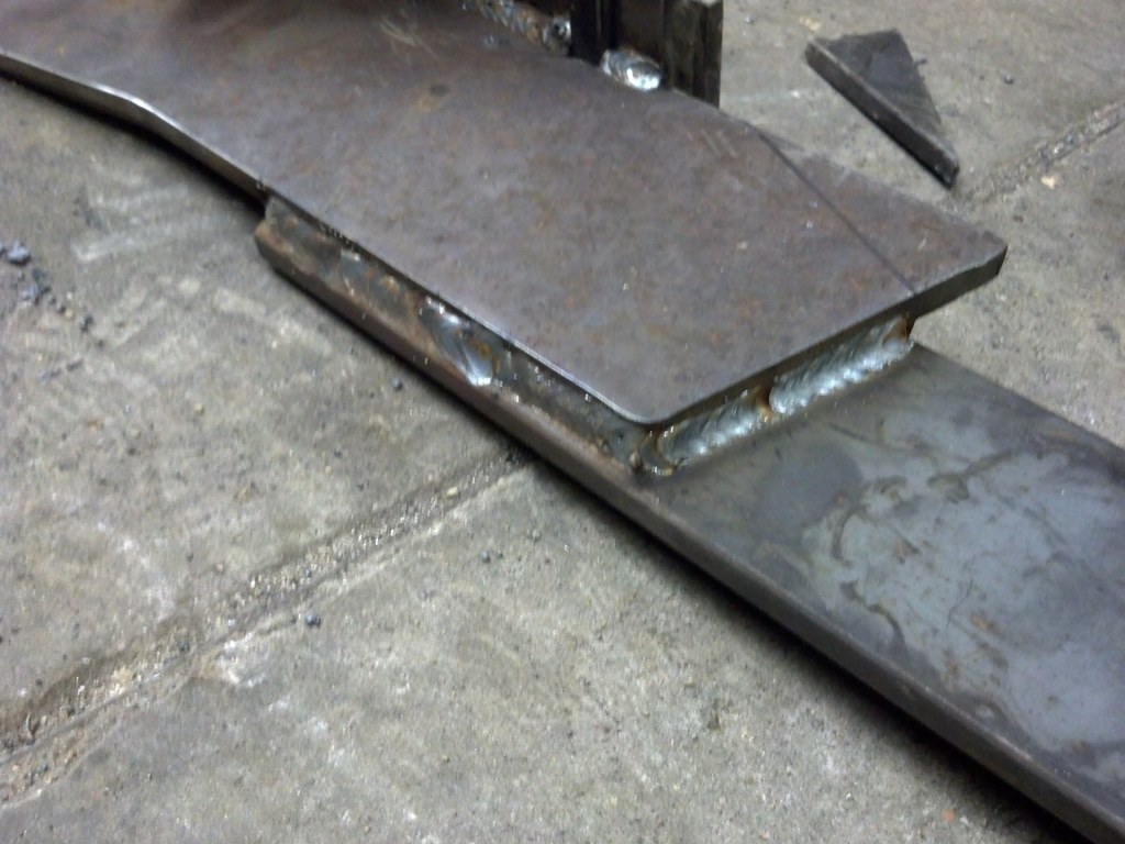

I fully welded every joint, since that will keep water from getting between the plates and causing rust, and stressing things further. It all bolted back up, and fit perfectly. Well, except that to get both upper pins in, you have to pin the right side, then relax the boom a little till the left side lines up... It's not off by more than 1/16", so it'll be OK. :)

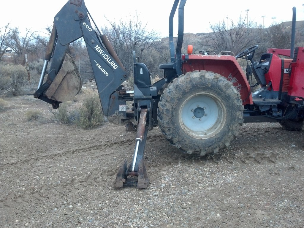

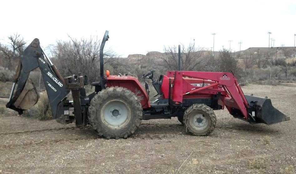

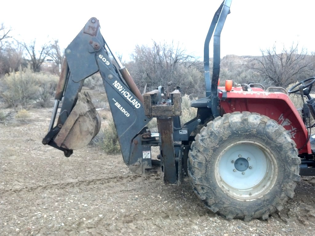

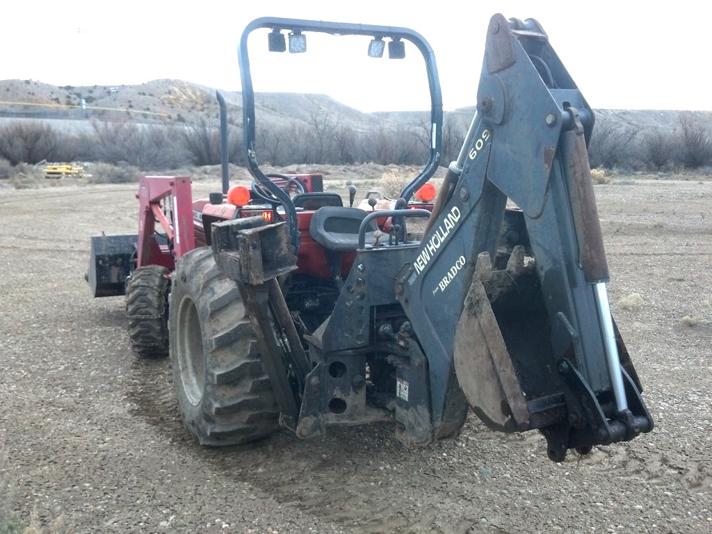

I used it some this weekend, until the bucket cylinder got to leaking so badly I was afraid I'd run the tractor out of hydraulic fluid!! I ripped out three cedar stumps, and maxed out the hydraulics many times... The mount seems VERY sturdy, and couldn't detect it moving at all.
I have to cross a wet wash to get to our property, and it has semi-frozen ruts. I did have some trouble with the backhoe dragging, even though it's mounted as close to the tractor as practical. I may use the second set of holes on the BH, which would raise it about 4". It currently has about 12" of ground clearance, and an extra four should be all I need.
But first I need to fix the leaking cylinder. I ordered a seal kit, and a new boom lock to replace the one that's missing. I already cracked the packing nut loose, which was fairly easy, so it shouldn't be a big deal to put the seals in once they get here.
Pretty happy with this setup... I'll go take a few pictures of the tractor with BH mounted so y'all can see the finished product...

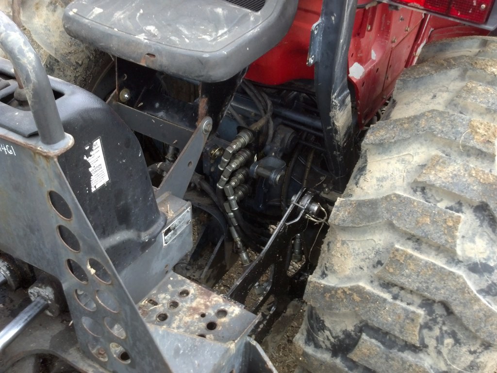

This tractor is set up with the pump feeding the FEL valve. The Power Beyond port of the FEL valve then feeds the 3pt hitch lift. I replaced the hose going to the FEL valve with 1/2" hose (from the factory 3/8") and used the biggest fittings I could. I then ran 1/2" hose from the Power Beyond of the FEL valve to the back of the tractor and a 1/2" quick disconnect. Normally, that hose is coupled to a 3/8" hose the feeds the 3pt lift. When I put on the BH, I disconnect there, and the 1/2" hose feeds the BH through more 1/2" hose. The BH returns directly to tank through another 1/2" hose and quick connect. The 3pt lift is disabled when the BH is connected.
There seems to be minimal restriction this way, though the first fitting off the pump's distribution block is an SAE O-ring to JIC6 fitting, but the SAE portion is small, with only a 1/4" passage... Suppose I could drill it out and re-tap it to 3/8", but so far it seems to be OK.
Took a couple of shots this afternoon...
Here's the rear of the tractor. The hydraulic connections you see are for the FEL. The BH connections are on either side of the ROPS, laying on the axle housing currently. I just got a 2nd 2-way coupler, and ordered snap rings to mount them to the ROPS for easier hookup and disconnecting. I'm going to re-locate the FEL quick connects down below the right side of the platform eventually, but for now, they are working ok here.
It's pretty tight in there, but I probably could have shortened the mount by a couple of inches... Would have to scoot the seat back too though, as it just contacts the fuel tank now... I'm 6' tall, so the seat position is good, and I'm happy with the current geometry.

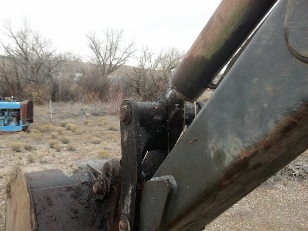

Here's my leaking cylinder... It dumps about a cup of oil ever time it's cycled, and if under pressure, it blows out around the packing nut, so both the packing seal and the piston seal are toast. Hopefully the cylinder isn't messed up inside...
