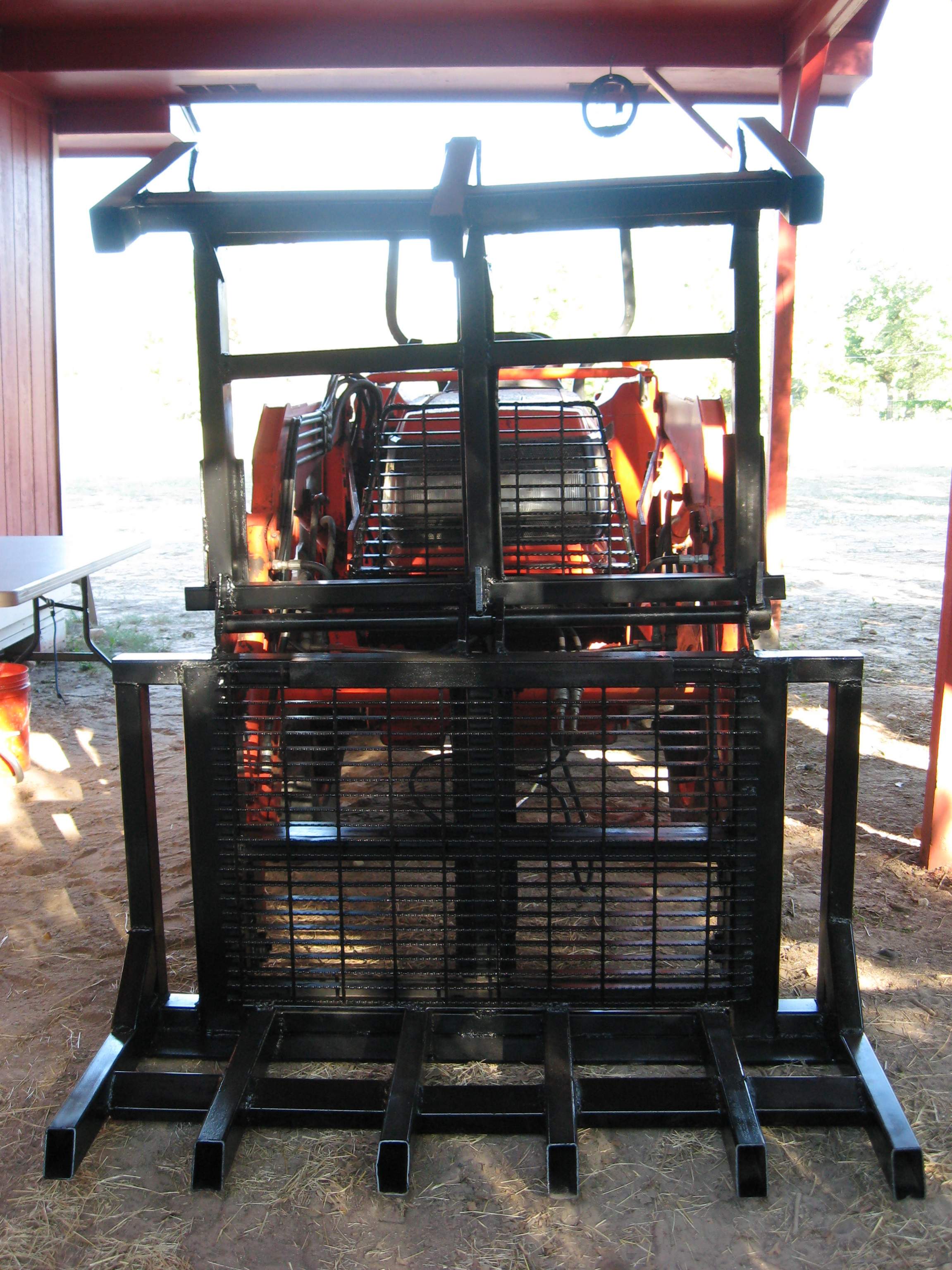

I have a L4310 - and a Shop Built Grapple - the 4n1 is too much for brush.
