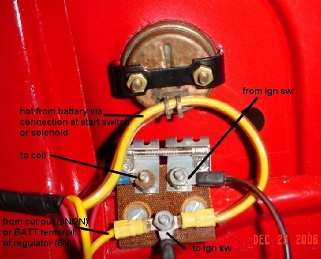

Pull a plug wire when it starts to act up and see if the spark is blue or yellow. When you put the new coil on did you put the resistor back in line? A 48 8N has the front mount distributor and it must have the resistor to keep from cooking the coil. Acting up when hot sounds like coil.

Mine never had a resistor on it…….
You don't have the factory ballast resistor attached to the back side of your dash panel?
Possibly. The only ones I’ve seen on the 8ns are mounted close to the coil.

Your '48 8N came from the factory with a ballast resistor on the back of the dash panel like in the photo. It allows full current at startup and as it gets warm it increases the resistance to extend the life of your coil. The resistors you are talking about are probably little white rectangles added to the coil circuit and they are added when you convert to 12v but retain the 6v coil to prevent frying the coil.
