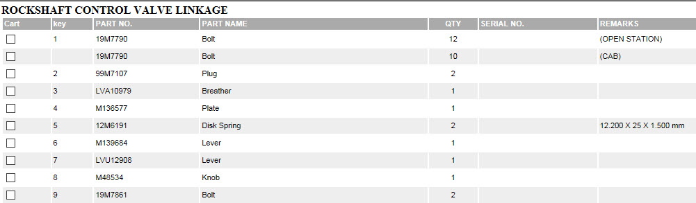

Just tighten the friction plates that hold it in position, I believe.
   / 4720 3pt hitch lift lever has loosened up / has no resistance - HELP
The 3 threaded bolts around where it goes into the trans housing ?
I thought about that, as I seen jamb nuts on them.
   / 4720 3pt hitch lift lever has loosened up / has no resistance - HELP #4
A picture of that assembly would help confirm it.
   / 4720 3pt hitch lift lever has loosened up / has no resistance - HELP #5
From JD Parts:
Thanks JG & Beenthere :D
#'s 4 5 10 12 13 14 should clamp down on the lever, once tightened.
I'll try it & let you know.
Thanks guys .

I was wrong. It only had 2 bolts.
I loosened the jam nuts, tightened both bolts some, locked jam nuts down :
Bingo - feels like it did before & works flawless.
Thanks again for all your help & concern :thumbsup:
