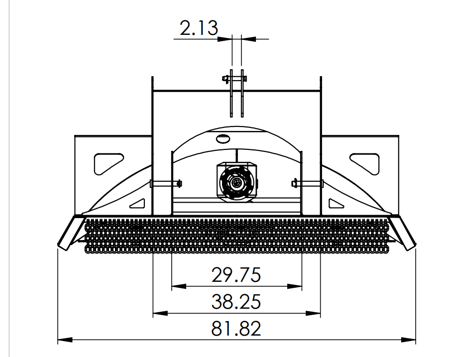

The really good news is it seems like they are moving right along with the redesign. They sent me a PDF with the new dimensions to make sure it's going to work. TBH I am not an engineer but it seems like the new spacing will work a lot better for Cat 2. Maybe someone with more experience with these implements could confirm this new spacing is going to work? Best I could do is figure out the mean distance between the 2 lower pins and it's 34".
For reference, the old spacing on the implement the maximum distance between the 2 lower pins was 29.75 inches. It's strange that number is being reused but maybe it was the easiest way to modify the design.

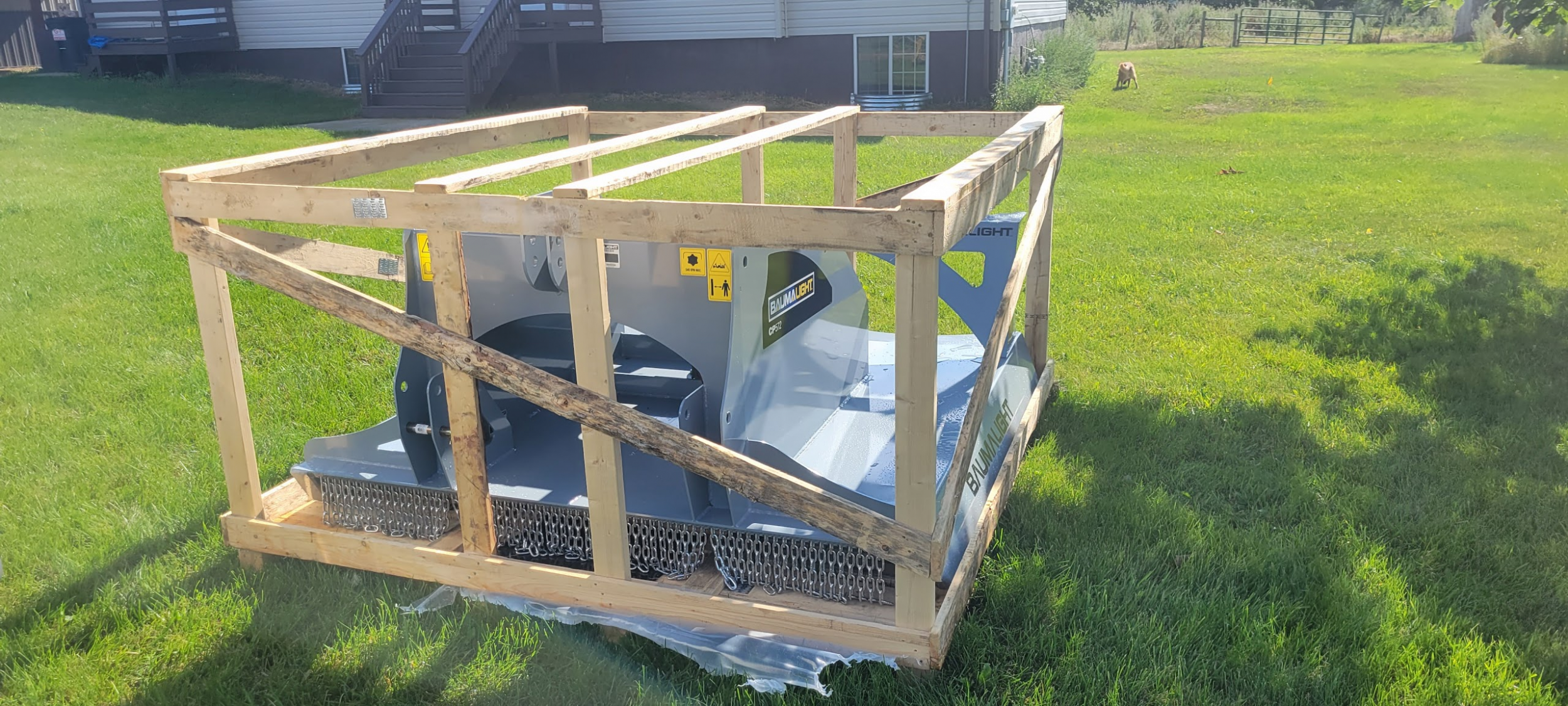

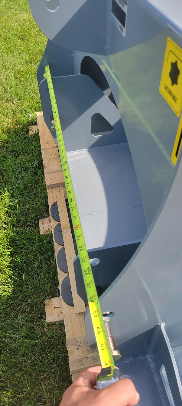

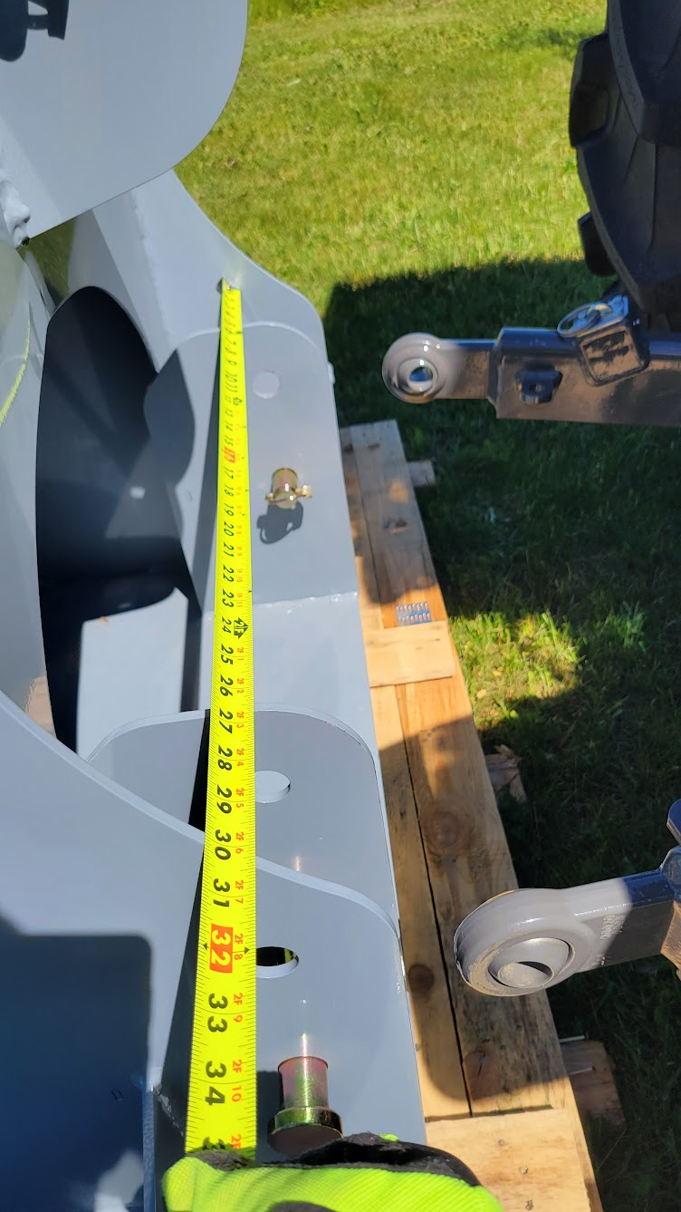

As promised here is the new unit. You can tell just by looking at it that the lower pin spacing is much wider
The new lower pin spacing is on the left and the old is on the right.
NEW OLD
NEW
OLD
