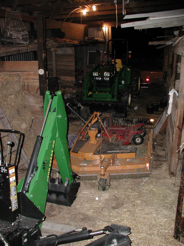

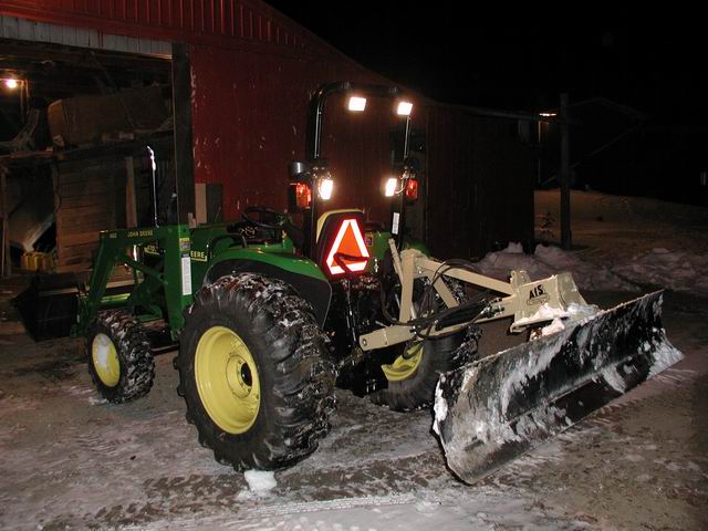

Just thought I would post a few pics of the extra lights I have added to my 4700 to better see at night. I have the 55 amp alternator, so there is plenty of juice to run them. The current draw is still well below what the stock fuses can handle for both circuits.
The (4) rear lights and ROPS mounted front lights (all JD 3" x 5") are tied into the "rear work light" circuit. The front Hobbs 5" x 7" grill guard lights are tied into the head light circuit so they will come on with the "road" position of the stock light switch.
Lets me see everything I need to while doing snow removal at night.

   / 4700 auxiliary lighting
#2
Another one.....

The "other" attachments that are resting for the winter....

I want to make sure I get this correct--you placed four more lights onto the same wiring as the original stock JD rear lights?? I am curious since I would like to add a pair of ROPS lights and it would make it a lot simpler to wire them into the same wire as the original stock JD rear lights. Mike S.

MikeS,
The (4) rear facing and (2) ROPS lights are tied into the "work light" circuit that is separate from the tailight circuit. I will verify this in my manual tonight. The headlight circuit has a 30 amp fuse and the work light circuit has a 20 amp fuse.
