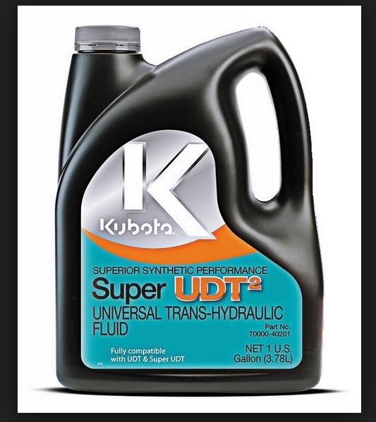

I thought I had done my research and I chose some hydraulic fluid called AW46 to use in my BX25. After I bought it, I looked online and started seeing some places selling AW46 and they said it was not recommended for transmissions, differentials or wet brakes. So I assume this is not good for my BX25? I bought it from Advance Auto Parts and they said it comes in AW32, 46, and 100. For some reason I thought I determined that AW46 would work, but now I am not sure?
I have not seen any locally available hydraulic oil advertised as being a suitable substitute for UDT. So what specifications should I look for? I have a Tractor Supply store nearby so if anyone is familiar with what they sell and can make a recommendation I would appreciate it.

This is what you should use. It's a case of you actually get what you pay for. False economy by going to a cheaper brand for a SCUT IMO. It may be worth it to use a TSC brand for larger tractors, but for only 3 gallons?

I would not use it unless the label states it is a substitute for UDT. I use NAPA 85-405 in my BX. Cannot tell the difference in operation from the SUDT2 K promotes as the only thing. now have 1500 HRs. The NAPA product at my fleet/military price is way less than 50% of the SUDT2

Plain hydraulic fluid is lacking additives that are needed for modern tractors' wet brakes and clutches. I would not use it for a tractor whose manufacturer calls for tractor fluid.
