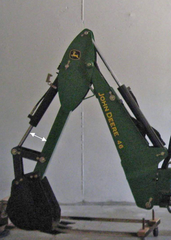

/ 46 backhoe ram bent? #19
Guys,
There is only one way that can happen. The rod has to be already bent at least slightly. A rock got between the cylinder and the boom or something similar. You might have missed it. Pulling and pushing forces on a straight rod are in the magnitude of hundreds of thousands of pounds.
here's the physics of it.
Stand on top of a beam that is 5 feet long times one inch in diameter in the vertical position and then put it horizontally and stand on it. You could put a car on it in the vertical position.
So my advice is to watch your boom at all times because it only takes one curl of the bucket with a rock wedged between the boom and the cylinder to do real damage.
Rob
/ 46 backhoe ram bent? #20
Rob-D Please excuse my ignorance with backhoe operation. I am more than interested as I await my new 2520 and my installation of a used #46 backhoe.
I have been following this tread with hightened interest after reading about members bending rams. Hopefully I will not bend the ram as I "slowly" get used to operating the backhoe.
I assume the section I must be aware of is highlighted with arrows. Looking at that section is it that as the bucket curls the position of the ram is also moving in an almost horizontal direction toward the boom? So it traps what ever is between the two and bends the ram over it?
