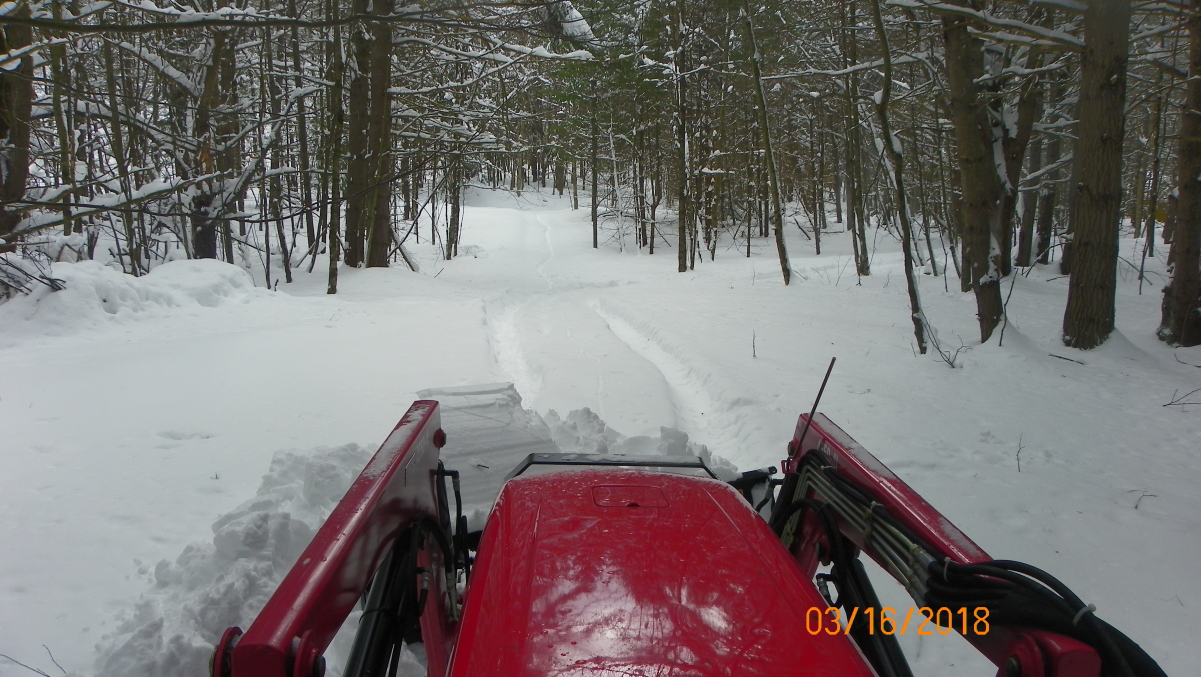

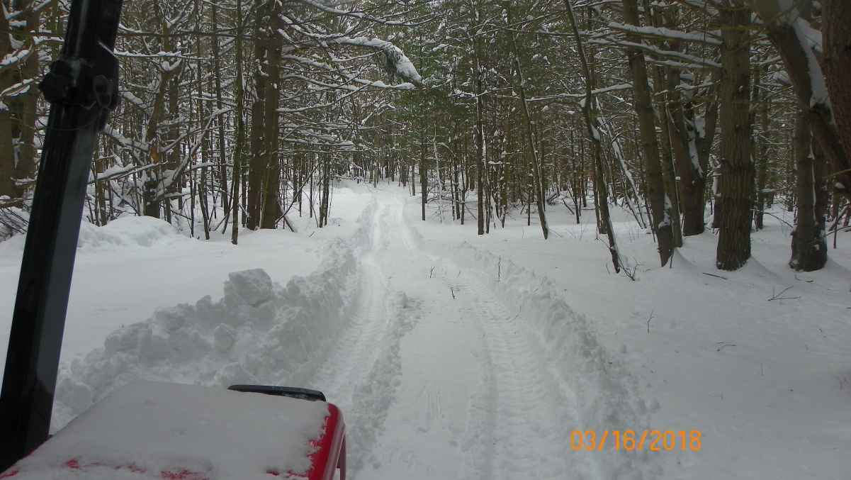

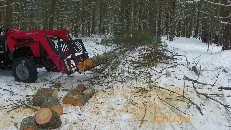

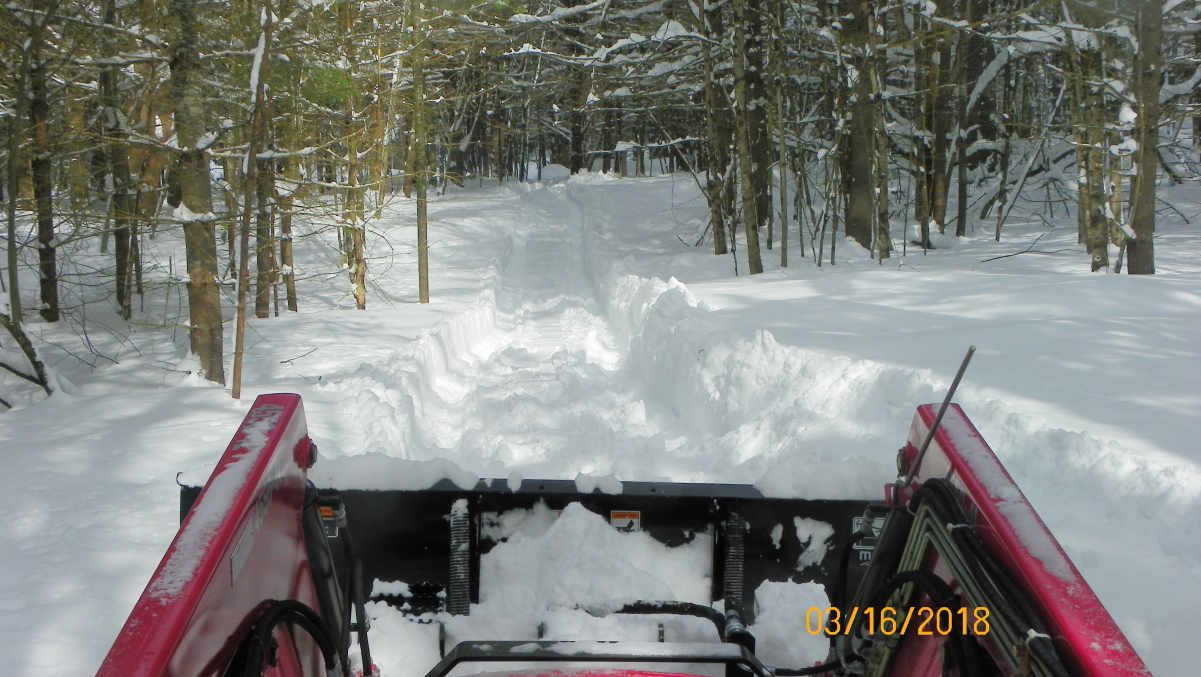

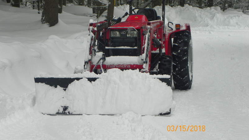

We have a 4540 that we bought new in 2016, it wasn't that the temp gauge was bad, they had to put in a inline restrictor coming out of the radiator which brought the temp up.
Before the inline restrictor it was like the temp gauge was broke but it just wasn't getting warm enough for a reading. We haven't had a problem with ours since we bought it, we have just over 630 hours on it.
We use ours for plowing in the winter and moving around some wood or brush, we don't have any chains but the back tires are loaded.
We've never had any fuel line leaks on ours, we finally had a new garage built this summer so I check for any leaks everyday and we've had nothing except after we got it back from its 500 hour checkup ( we had all fluids and the filters changed) after getting it back there were no leaks but one morning I saw a small spot on the cement, I found the plug that had loosened up but after getting on it with a crescent wrench everything is fine.
We did get the backhoe with it (4550B I think) we have lots of sand so when we dig out stumps it goes pretty good if you start out wide and then work your way in. We also bought a plow with a third funtion valve kit so we don't have to get off the tractor to angle the blade. We also have a set of pallet forks from Mahindra that get used a lot.
