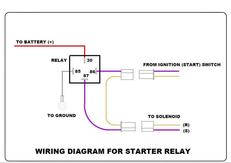

I have a 2014 Mahindra 4530 4WD Tier 4 tractor that I've owned since new. It only has 140 hours on it. This spring, it started not starting with the key. Wouldn't do it all the time, just intermittently. Now it will not start at all with the key. I turn it to the "on" position and then further to start and I get nothing. Not even a click.
I've taken the battery cables off and cleaned them good and made sure they have good tight connection. I did the same with the ground to frame cable. I also did the same with the cables on the starter solenoid. Still got nothing.
I have to start the thing by touching the two prongs on the solenoid. Would this likely be the neutral switch or a bad starter solenoid? Any way I can check to narrow it down?

When you turn the ignition switch to the start position you are supposed to send battery voltage to the starter solenoid. Your jumping the wires at the solenoid is accomplishing this.
Take a volt ohm meter and attach the red lead to the wire coming from the switch and the black lead to a good ground if the volt meter has a on/off switch turn the switch to on. Now turn the ignition switch to the on position The volt/ohm meter should register no voltage. Now turn the switch to the start position. The volt/ohm meter should register battery voltage with the switch in the start position. Less than 12 volts means low voltage is being sent to the starter solenoid. No voltage mean the switch needs to be looked at.
A lot of tractors and lawn mowers experience this no start.
John Deere sells a relay component kit to correct the problem. You can also purchase a relay and electrical wire and end clamps or spares at a parts house and do the same thing as the kit.
pin 85 goes to chassis ground (85)
pin 30 goes directly to the battery + (30) incorporate a fuse
pin 87 goes to the starter solenoid where you remove the wire coming from the ignition switch.
pin 86 attach the wire coming from the switch, presumably on your dash (86)
If the relay has a 87a do not place anything on it.

If you can start it by jumping across the solenoid then the battery is fine. The solenoid is energized by 12v from the ignition switch when the switch is in the "start" position. It would be coming to the solenoid on the small wire. You should be able to test for 12v on that terminal with a meter or test light while someone turns the key to start. If you have the voltage with the key turned then the solenoid is bad and not energizing to apply the voltage across the two terminals internally as you were doing when jumping them. If you don't have the 12v then look at the ignition switch. Good luck........
