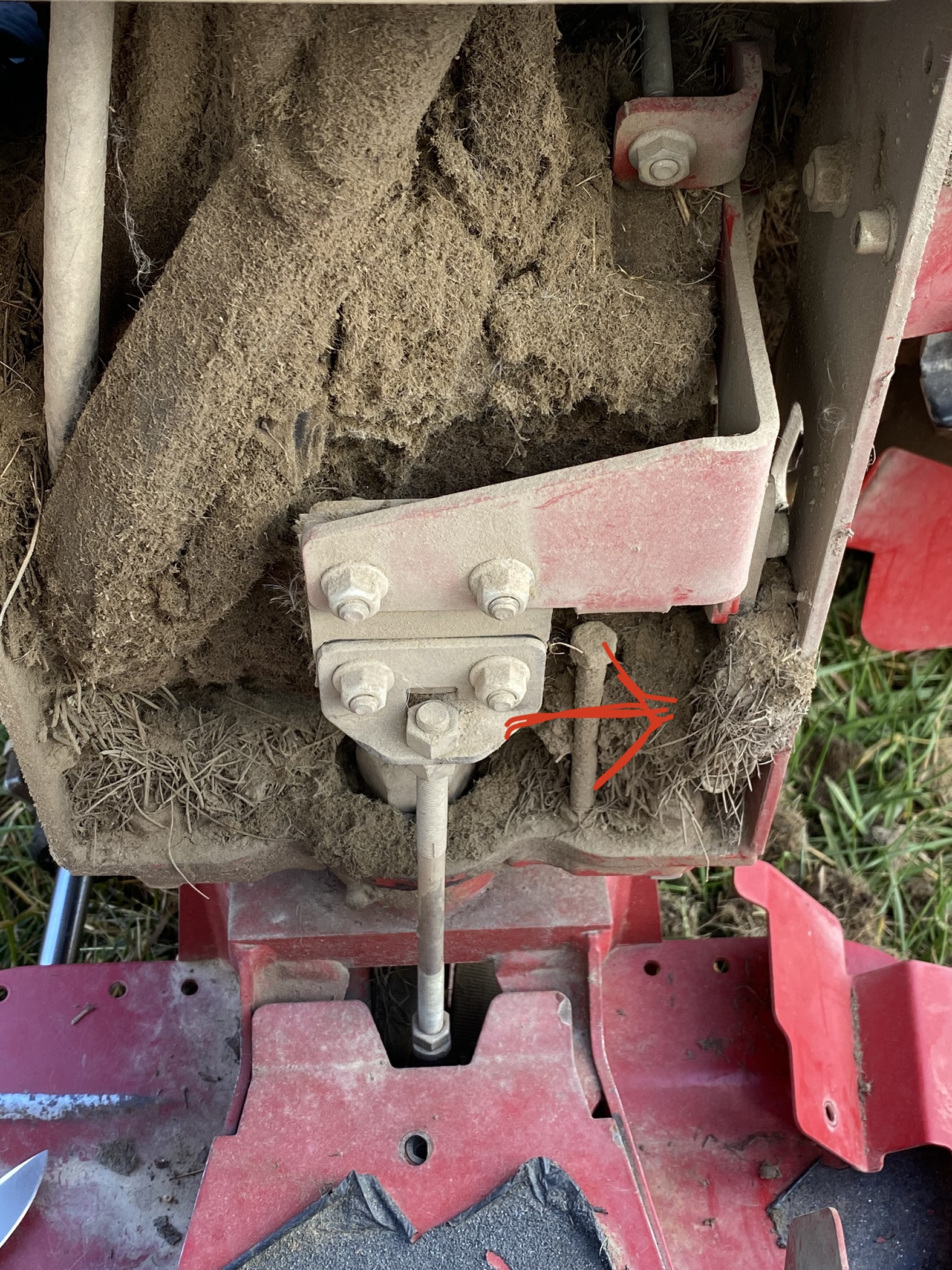

My wife was using the Ventrac with tuff cut Mower. She had just gotten started and wanted move something so turned it off , got off and then when she got back on, it wouldn’t start.
No click, no nothing. When I turn the key, the dash lights come on. I dont hear the steady rapid clicking of the fuel pump. I dont hear it turn over or a click of a solenoid. Voltage says 14.4 or 14.5
I put a meter on the battery and got 14.6. I put the meter on the starter. Red to red, black to the white cable that is attatched to the starter and it reads 14.5 when in the “on” or run position. Does anyone have any ideas? I pulled fuses and they look good.
