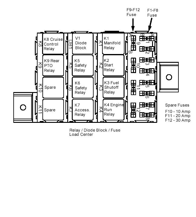

I have a 4500 that won`t engage the pto. I have a lite on the dash but no pto. can anyone help,,,,,,,,,,please
   / 4500 #2
On my 4500, I occasionally have to slightly twist the PTO (pull out only) knob to clear the PTO interlock so it can crank. Possible your PTO switch is cranky in a different manner: try twisting slightly when out? Also, fuses all OK?
   / 4500 #3
Might try switching out a relay on the fuse board panel (if you have a spare would be good).
Likely to look like this..
   / 4500
thanks guys but I have 12 volts to the solinoid so I`m thinkin it may be in side any more help would be welcome. There was a post some time back from a guy named kelly that had the same problem. He said something about some sort of points were corroded.I wish he would reply. Kelly I live in Union you said you were from St. Clair Mo. Please reply
