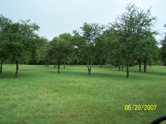

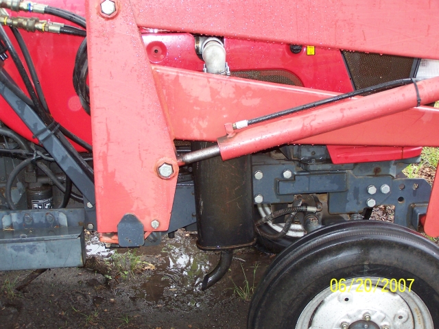

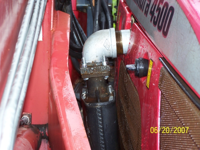

I think I solved my muffler problem. I used 2" galvanized pipe elbows to route the pipe out of the engine area. On 2 of the 90 degree elbows, I had my local welding shop weld a 1" thick flat plate in which bolt holes were drilled to line up with the exhaust manifold and the muffler. Now my muffler hangs straight down the side of the tractor and it won't get hung up in the low tree branches where I mow.
Hmmm, I was going to post some photos, but there's no button to click on to attach them. Aha, I see it down below. I'll post photos of the rerouted muffler and a photo of the area I mow that used to catch my muffler.

/ 4500 Muffler reroute
#9
Yes I can. The side cover only has to be lifted about an inch and then pulled down and away from the engine. There's enough play in the pre-cut hole in the side cover to allow for the 1" lift to remove it. I also didn't have the screwed fittings welded together, so they can still be unscrewed. I used 4 pieces of 2" threaded pipe: 3x elbows and 1x 3" straight with male threads on each end.
My only concern at this point are sparks coming out of the muffler and causing a grass fire as I mow. I've never seen sparks come out of the muffler, but I suppose it is possible.
