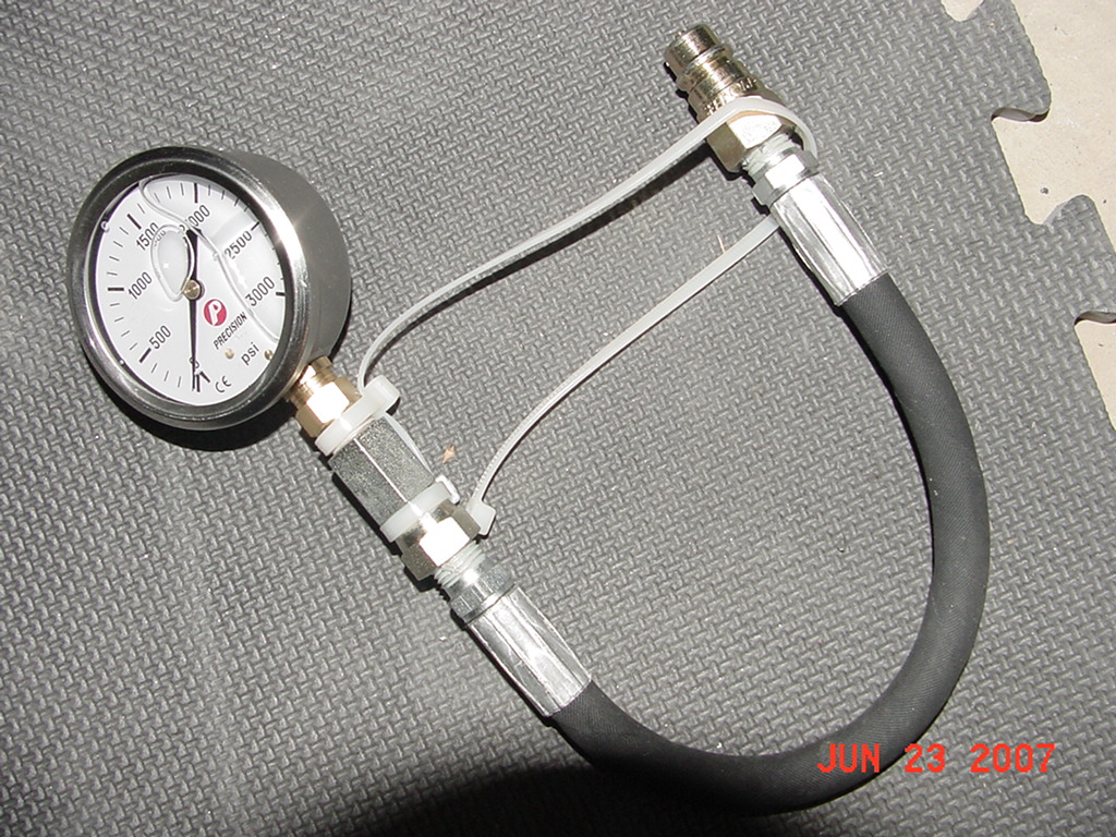

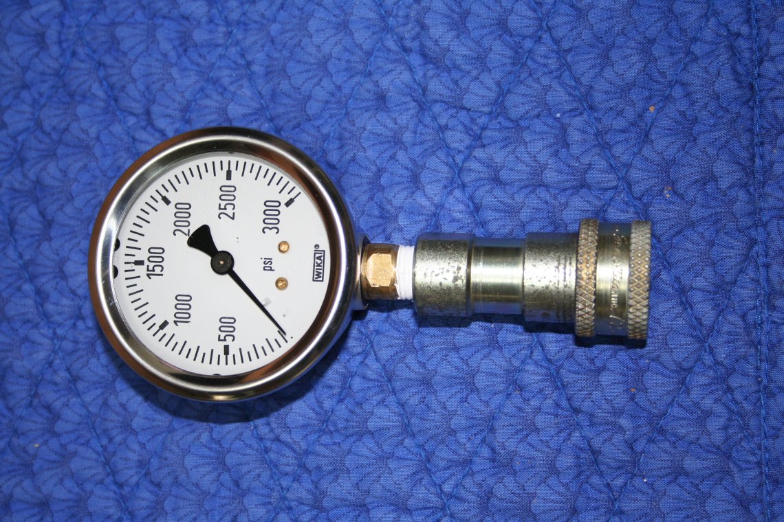

Either your cyl is bypassing internally, or the spool for the stabilizers are leaking.
You can test the the cyl with a shut off valve in series with the base end cyl port.
Extend the leg, and shut off the fluid flow to the base end of the cyl. If the legs collapse then the piston seals are leaking.
When extending the stabilizers, does the relief come on or squeal?
A 3000 psi Hyd gage would let you monitor and trouble shoot the hyd system.
Something like this.
