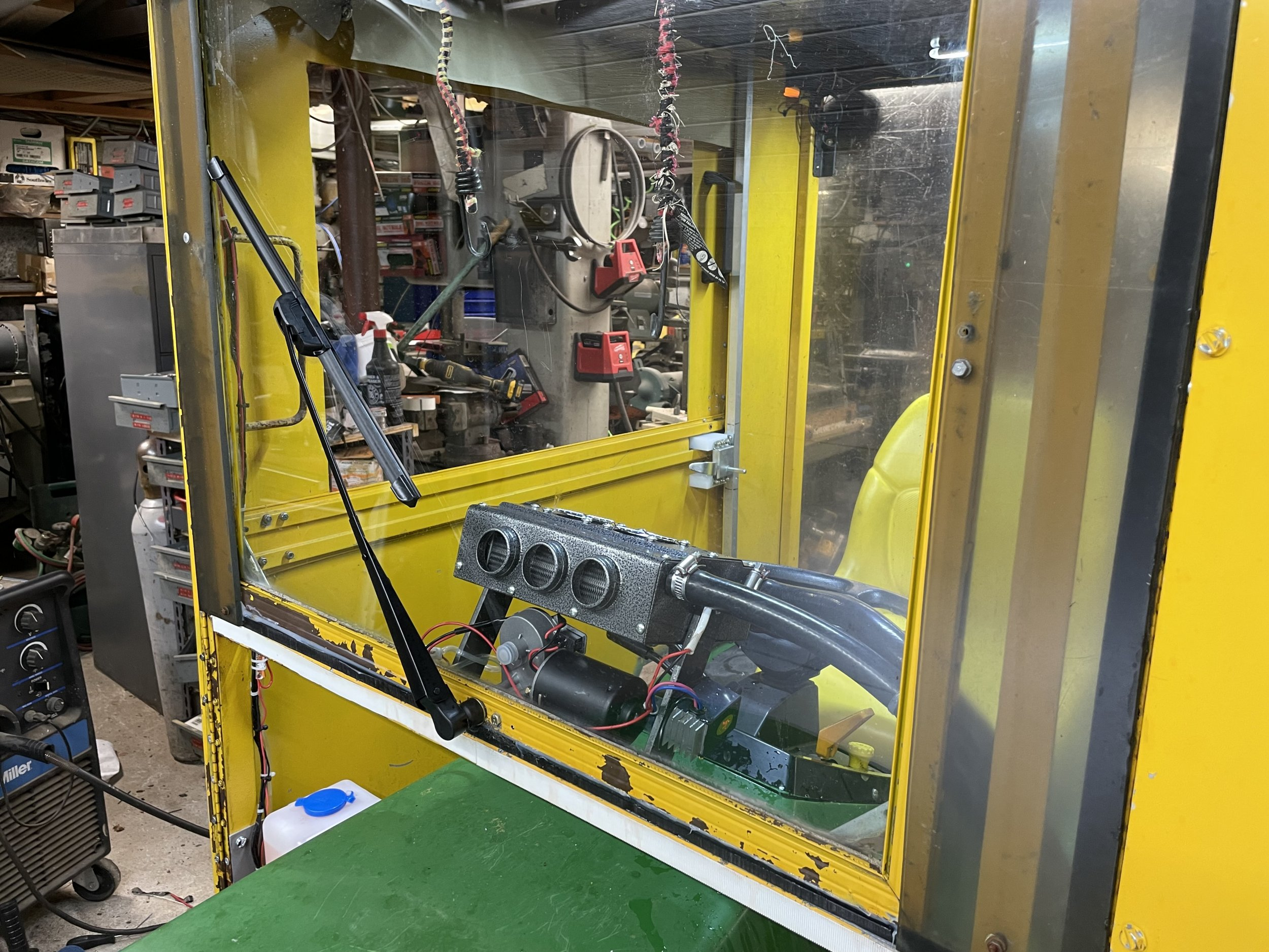

I found a old home made cab for some unknown tractor for $20 at a swap meet. I fixed it up and modified it to fit my 445. Now I'm adding heat. I've seen people "T" into the 3/8" bypass hose for the supply and then "T" the return into the Lower Radiator hose. I was wondering if I could just cut the 3/8" bypass hose and route it to the heater core and return to the other side of the 3/8" bypass hose. This way I'm only cutting one hose. It seems to me the only downside to this is that I won't be able to shut off the heat. What does this bypass hose even do?

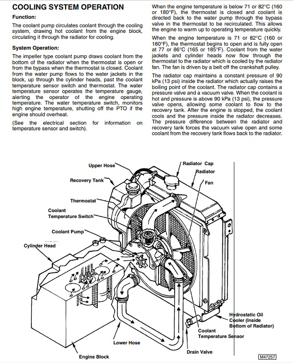

This schematic may help sort out what you are looking for.

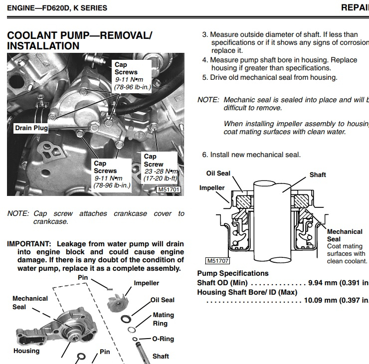

Added a pic of the drain plug on the water pump.. might help for a place to get warm water. And for sure it is a metric thread. ;) ;)
Also, found this video channel with this video about putting heater in a cab on his JD 425, which is the same system used in the 445.

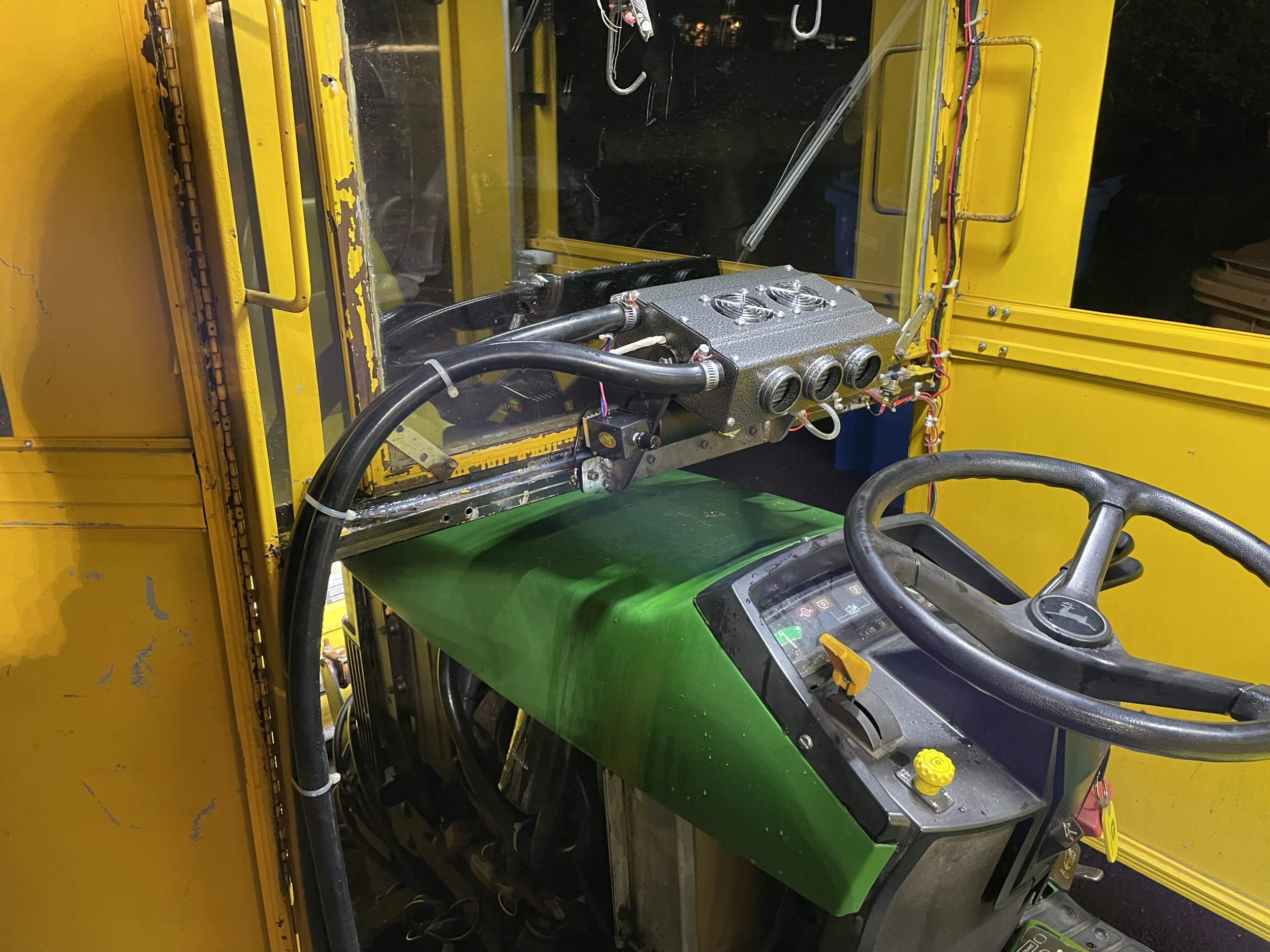

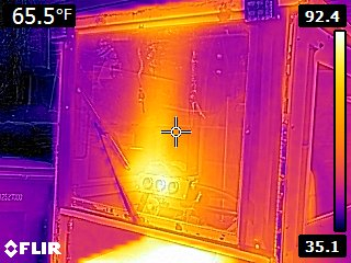

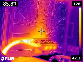

This video is where I got the idea to use the bypass hose. The difference between what he did and what I did, is he Tee'd into the bypass and returned to the Lower hose. I rerouted the bypass through the heater core returning to the other side of the bypass. It seems to work great! I guess the only downside to the way I did it is I can't shut off the water flow.
