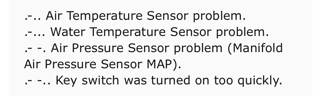

Just rebuilt both heads. Center light is throwing codes. Where are the codes available
/ 445 John Deere EFI blinking coded #2
Pic of the code you are getting might help... I'll look for it on the service tech manual (or do you already have that?).
s/n above or below 70000 ?
/ 445 John Deere EFI blinking coded #3
/ 445 John Deere EFI blinking coded #6
Does a X485 use the same codes? I was getting 2 long & 2 short today, but cleared after a restart.
