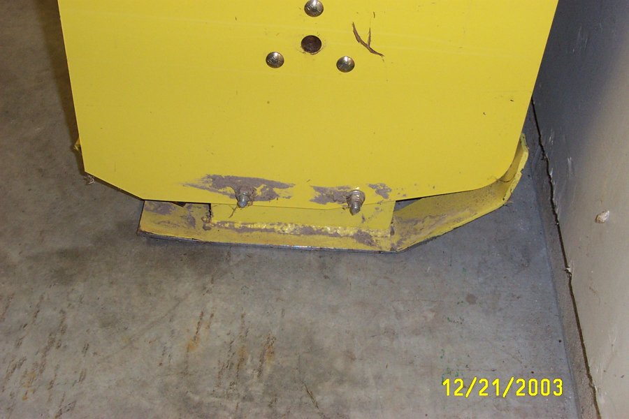

59/4310 combo an unfair workout. I too have a 1200' driveway of white rock but I took the factory skids off the
59 and replaced them with home made sled runners. Here's a picture of the skids.

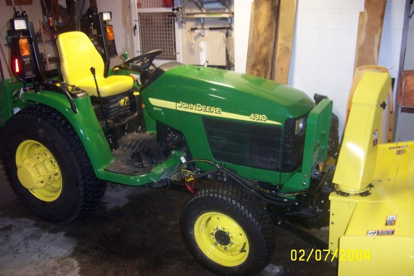

here's a picture of the 4310/59 after nearly all of the snow
had melted off after using it. As you can see in the photo,
I have the turf tires and I have mfwd. I love my green.

I want to make a suggestion, if not to late. In your photo the front guard for the FEL is still on the tractor. I found out if you rotate the defector ( Blower in raised position) it will hit the guard. I did not have any damage just a little missing yellow paint.
My 4300 has power to handle the 59" blower. I make sure to run in mid-range on the Hyd drive. In high it loses a lot, Low range is to slow.
DPR
   / 4410 and moving allot of snow #15
Tanuke01,
I already checked the clearance of front guard / discharge chute. It is close, but has enough clearance to miss.
It's about 1/8 inch. If I make sure the slack is
taken up and push the guard further back it clears about 1/4 inch. Of course, the tolerances on this kind of fit up are
not those of a fine swiss watch. It could be that the 4310 is
slightly different than the 4300. Who knows
