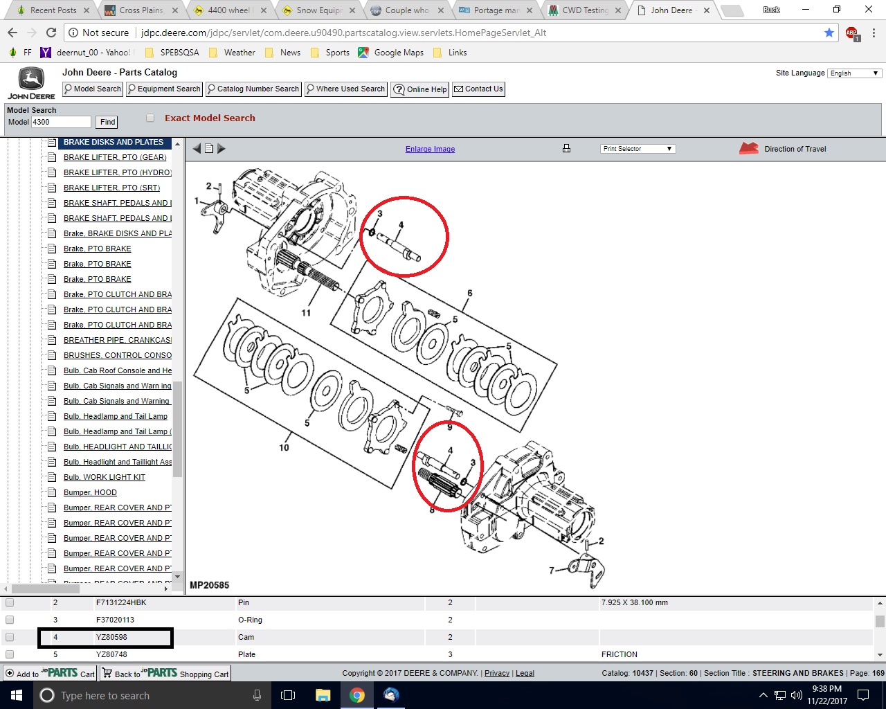

/ 4400 wheel locked #7
dfkrug
Would that be the cam "shaft" key 4 part that is circled in red on both right and left housings?
I will see about lubing those shafts if so. And hope lube will help keep them free to move.
tks for the heads up.

/ 4400 wheel locked #9
and left housings? I will see about lubing those shafts if so. And hope lube will help keep them free to move.
Yeah, looks to be #4, BT.
There is also an O-ring in there, which keeps the inner part of the shaft lubed. Outside of where the
O-ring is is where you get corrosion. Keeping it lubed with some kind of oil and using your brakes
often is helpful. Getting fertilizer, road salt, and livestock effluent on the housing is a recipe for
corrosion.
Note that WD-40 evaporates, so it may help with loosening up the shaft, but you really need oil
in there.
