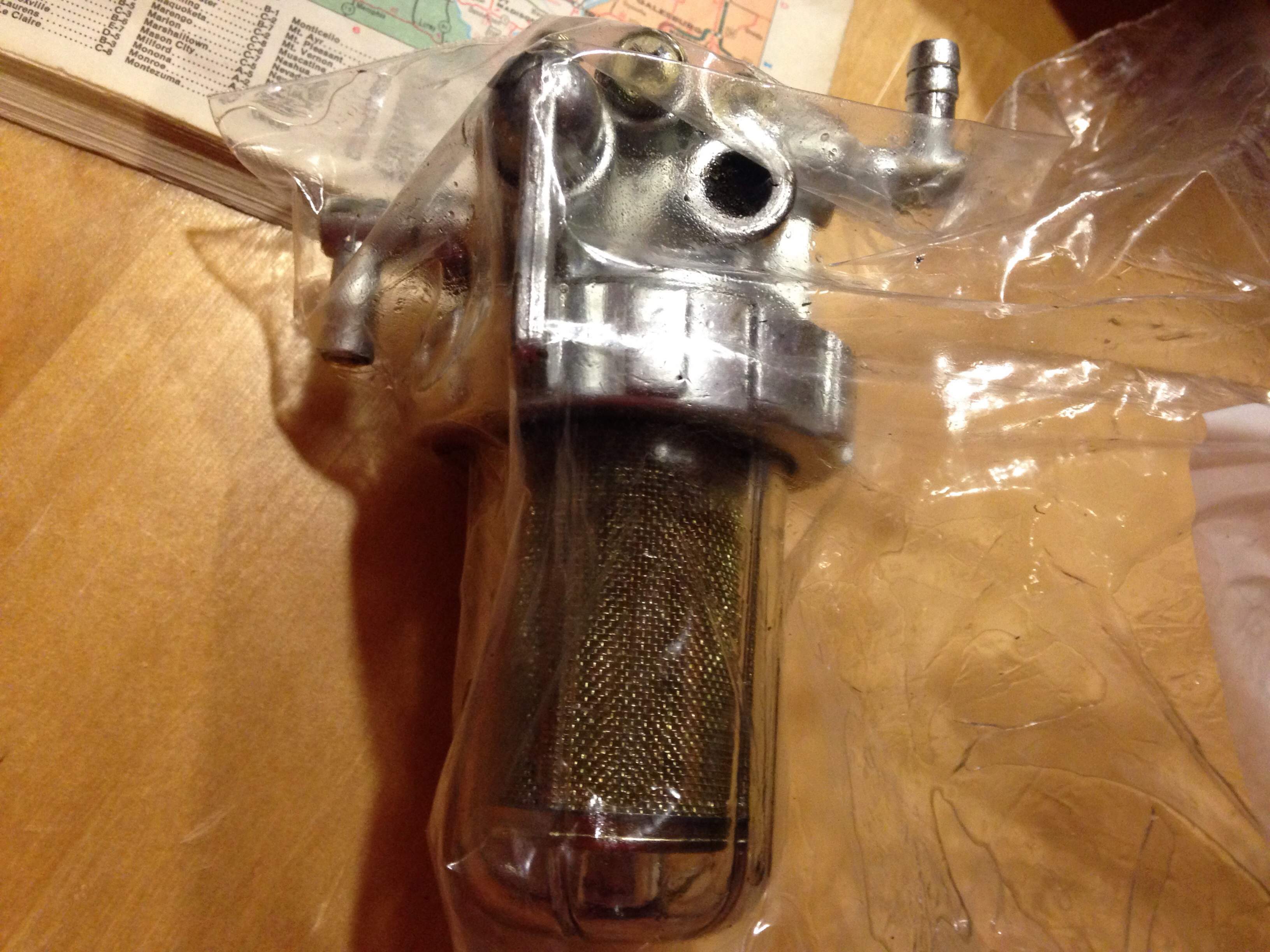

dewcrew8
Jun 1, 2014
9
Ia
Tym lm43h
Does anyone have the part # for it or A good aftermarket one with the same wire/filter and glass body.the outlet came out of the main body , it looks like they just glued them in.
/ 433 glass fuel filter assembly? #2
Common problem. What I did was get a pipe tap and tap threads in the hole. Went to auto parts store and bought a threaded fitting, put pipe sealant on threads and screwed it into the housing. Quick fix.
/ 433 glass fuel filter assembly? #3
I think the Mahindra 4510 is made by TYM and has the same problem. One I used JB epoxy and that helped but your idea I think has more merit. What size etc did you use? The other problem on my tractor it is too exposed and gets hit by brush etc. and is prone to damage.
ya john deer has the filter but its 80$ and they said to jb it and it works for now.
