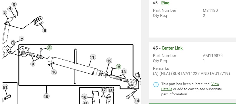

Hello,
Need to purchase a replacement ORIGINAL 4310 Center Link . . . the model # is AM119874. Would this be the complete Center Link Assembly? No photos to look at online; also, the model # LVA 14227 has appeared on some web sites as a "newer" replacement Center Link Assembly for the 4310. Is there any difference between these two different Center Link Assemblies with different model #s?
Just trying to be sure before I order.
Thanks for any help.
FredSG
/ 4310 Replacement Original Center Link Assembly #2
Here is a shot from jdparts on the center link. part # is AM119874, key 46
Not sure what you mean by Original.. but looks like the AM part is substitute for the LVA..

If you don't mind me asking, why must it be an original replacement top-link? According to JD Parts there are two parts that make up the replacement top-link:
Part Number:
LVA14227 Qty-1 Center Link - LINK , UPPER CENTER
LVU17719 Qty-1 Retainer - RETAINING CLAMP CENTER LINK
Replaces Part: AM119874
Description: Center Link - CENTER LINK
The total is around $225. You can get a Cat-1 top-link that will work just as well from TSC for around $30.

Hi Beenthere and Jgayman,
When I wrote original I was just looking for the same part # as listed in my 4310 parts catalog . . . there has been an upgraded center link part so I just wanted to be sure I was looking at the same replacement part, either a JD part or one from TSC.
Appreciate the posts and help with my OP.
