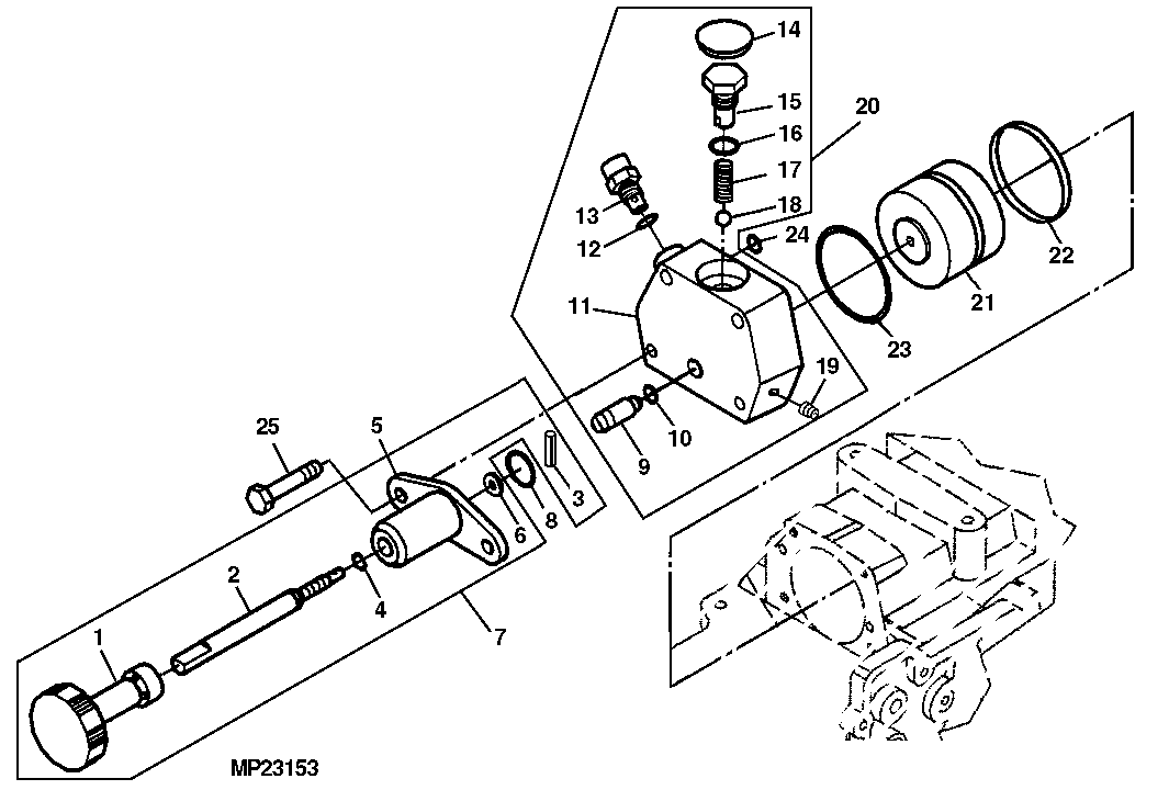

On a JD 4310 with a FEL...
The 3pt goes up fine... but no matter how the drop rate knob is messed with the implement on the 3pt will come down about 1/2 way based on knob position (more open the faster) - but then the last 1/2 or so of the descent to the ground the implement moves very - very slowly down...
Thoughts?
   / 4310 rear hydraulics don't go down all the way #2
The Rate-of-Drop valve need to be disassembled and cleaned I think, there have been a few issues with them...
That's within the Rock shaft assembly - right? A real bear to do!
   / 4310 rear hydraulics don't go down all the way #4
It should be on the front of the tranny, under the seat:
