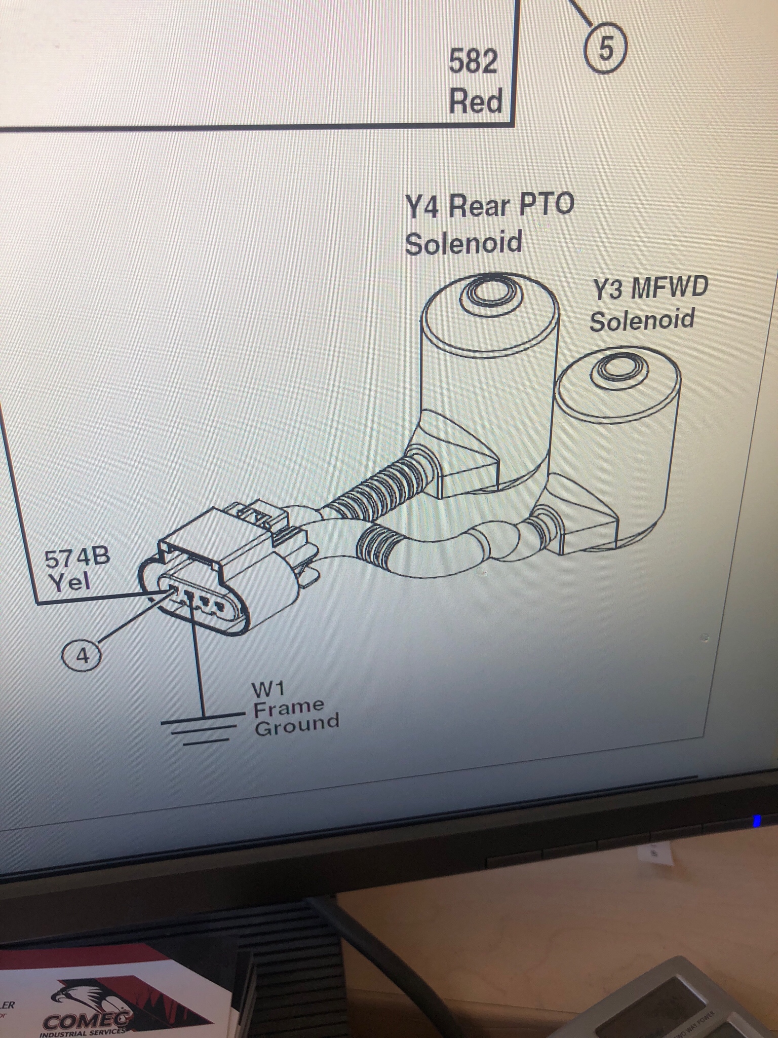

Swap the 4x4 and pto connections and see it the circuit is working. I think they are the same connector at the solenoid.
   / 4310 PTO not engaging, unhooked wire?
#12
They are on the same connector so would have to jump them i guess..
#13
Update: Solved
Don’t know exactly what was wrong but its working now.
Pulled the coils off the solenoid valves and pulled the connectors apart. Swapped the coils and tried it. Still nothing.
Removed the valve to check it out. Used the MFWD coil to test the valve and it worked.
Reinstalled the valve. Hooked up again and all is good.. valve must have been just stuck closed cause she works like new now.
Thanks to all the suggestions and help!
   / 4310 PTO not engaging, unhooked wire? #14
I'm wondering if you didn't get a speck of foreign material into the valve and it stuck closed. Highly unlikely but possible. Another scenario could be that a bit of water settled into the valve and lightly rusted it. It took you taking it off to distort the metal enough to release the plunger.
Awesome that it's working now without having to spend a lot of money.
