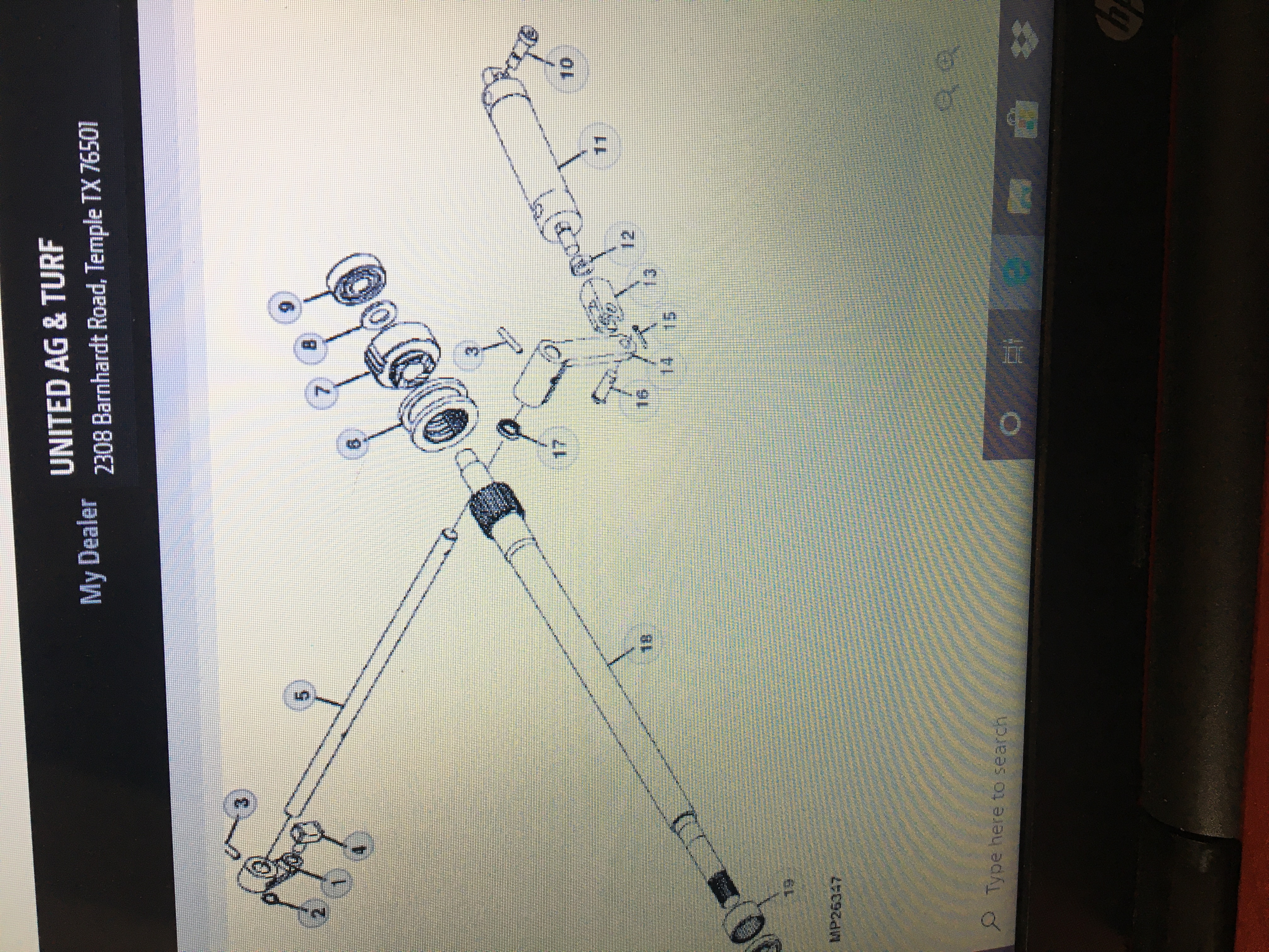

Shame on me I hit a stump in the pasture. I broke the suction screen housing which they call a cap. Also I broke the lever and actuator that engages the 4 wheel drive. Many dollars later I received the new parts. When I removed the roll pin from lever I pulled out on the shaft and rotated it. Well i must have miss aligned the gears because I do not have 4 wheel drive and the lever just turns freely. Do I now have an internal problem and have to take the transfer apart or is there a procedure to align the shaft and gears. Thanks! Merry Christmas!

Okay here is the parts page for your eHydro MFWD selector.
John Deere Parts Catalog

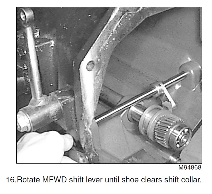

I haven't located the shift lever for the eHydro in the service manual but it looks to be similar if not the same as the power reverser.
This is the photo they have of that.
Sounds like you moved the shaft and disengaged that shift shoe from the collar. You might be able to feel your way through getting it back in the slot. If that little shoe falls out you will most likely have to split the tractor to fix it. The shoe I am referencing is illustration #4 on the parts page.

#14 is the lever I was replacing and #5 is the shaft I pulled and misaligned. So how do I correct this?

#4 should be in the grove of the collar of #6. Before I split the tractor I would take the rear PTO housing off. It's not hard to do and i'm sure you would be able to poke #4 into place without splitting the tractor. You might need to pull the whole PTO clutch assembly out of the rear differential housing to get enough room. You will need to remove the pin on #14 again and push the #5 shaft back in enough to be able to slide #4 into the grove. Then just be careful as you put everything back together again.

Looking at the illustration from my service manual it seems it wouldn't pull out at all unless it had already been rotated far enough to disengage the shifting shoe (4) from the sliding sleeve (6).
EDIT: I just noticed the shifting shoe (4) should be retained by a push nut (2) so maybe it is still in the lever (1). You may have rotated the shaft 180 degrees when you put the roll pin back in. You might be able to disconnect the lever, rotate it 180 degrees, then push the shaft all the way in and see if it will engage the slot when you rotate it back in place. Be gentle while feeling for the shaft engagement and you should be okay. Once you feel the shoe hitting the sleeve it might take a few tries to get it to turn right and go in the slot.
