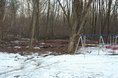

Pic # 2 - I hope the snow doesn't chill you folks down south... it's still hanging on here even though it was 55 today.

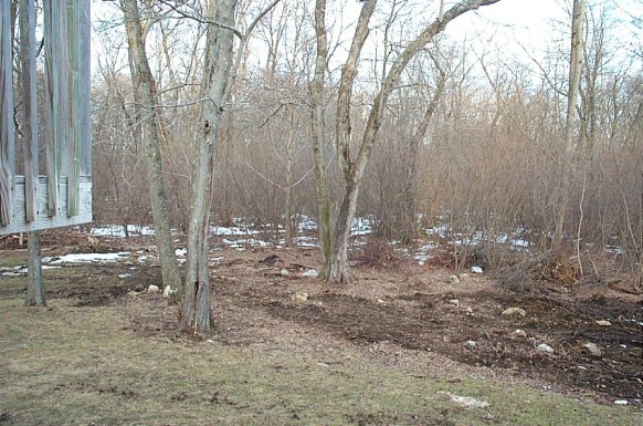

And the last pic - This one might be a bit larger - I'm experimenting with larger pics with more compression.
Now that you've seen these feel free to offer advice on grading blades - front mount vs. rear mount.
Thanks All! /forums/images/graemlins/cool.gif

Steve,
Do you think you should notify the authorities?
The tractor has been stolen from your pictures. /forums/images/graemlins/smile.gif /forums/images/graemlins/smile.gif /forums/images/graemlins/smile.gif
Anyway,
It looks like you already have a loader so how about
a rear blade or rear box blade? It would cost a lot
less than a front blade. If you don't have a quick hitch
or Pat's easy change you might consider one. No more
wrestling with attachments or pinched fingers. Best
thing I ever bought. In our area TSC has the best price
but you have to buy your own can of green paint.
