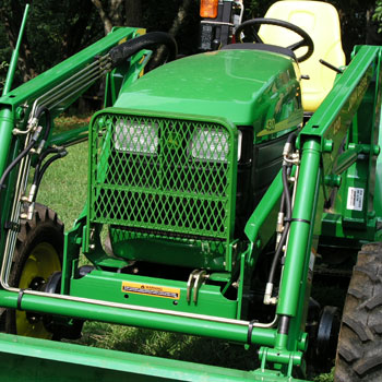

I finally got around to finishing my custom grill guard and had to show it off to somebody. My local newspaper declined to do a feature article about it. /forums/images/graemlins/grin.gif No more worries about putting a branch through the grill or headlights when pushing slash piles and bush hogging in the really tall weeds.

You're right... /forums/images/graemlins/blush.gif You can't puncture that... why you can't even see it... it's built so well... /forums/images/graemlins/tongue.gif /forums/images/graemlins/wink.gif

/forums/images/graemlins/blush.gif /forums/images/graemlins/blush.gif /forums/images/graemlins/blush.gif Thanks John,,,High praise indeed!!! I was sure I attached that file. Lets see if this works.

I like it... /forums/images/graemlins/cool.gif
That will be great for loading a truck as a front bumper/protection from your unit... but don't blink while brush hogging or out in the woods... cause... a sapling or sharp branch will sneak its way up/under/around/and through to get ya... when it wants... /forums/images/graemlins/shocked.gif
(and don't you dare ask... how I know all this... /forums/images/graemlins/laugh.gif)

That's exactly what I do with mine. I've now got some green paint on my dump bed and a bit of orange on my grille guard. /forums/images/graemlins/blush.gif Better that than a mashed grille and crushed radiator, though. /forums/images/graemlins/smile.gif

Jimmy D ,nice grill guard , did you say they have a anti fog kit?? mine fogged up after about 5 hrs. and its a bit hard to see around the fog. Thanks ,Rich

Shari, I don't know the gauge of the expanded metal but it is the heavy stuff. It was a scrap I bought from a local wrecking yard for $8.00. It's welded to 1/2" square stock that was heated, bent to curve around the radiused top and welded to the inside of the factory guard. The finished unit is turned in the opposite direction from the factory mounting orientation. Grainger or McMaster-Carr, I can't remember which, sell several varieties of expanded metal sheet in 2X2. I think it runs about $15.00 plus shipping. They both have pretty good web sites. Now if it will just dry up so I can get back to mowing. Rained off and on all night.

I used the factory grill guard that comes with the loader and modified it. I bought the peice of expanded metal from the wrecking yard. It only weighs a few pounds. The 1/2" square bar stock was scrounged from a good neighbor who was kind enough to help me with the fabrication. Sorry if I was unclear.
