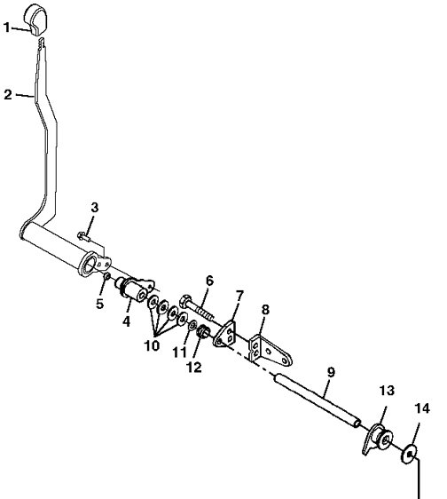

Not for sure, but the owner's manual references the screen and check valve if 3pt operation is erratic. It is located in-line right by the yellow fill cap of hydraulic fluids. They say to take it apart and clean it if necesary...Keep us posted.

It just seems like there's not enough friction on the lever mechanism too keep it in one place... Put a call into the dealer, fortunately I'm under warranty.

Anyone? Bueler? I took my seat and everything off yesterday - couldn't see anything to adjust...

Patrick,
The lever is kept in place by what JD calls disk springs. Look at the attachment, they are part #10.

Hmmm... Is that something I can just tighten up, or does it mean that they're thrashed? When I had the seat, etc. apart, it didn't look like something I could take apart...

You would almost have to take it apart to know for sure, but it looks like you could put a spacer washer in to put more pressure on it.
   / 4310 3pt problem!! #18
THE FRICTION WASHER ON MY 4310 BROKE IN HALF. PART NUMBER M136623. THE SERVICE MANUAL SHOWS VERY LITTLE ABOUT THE REPAIR. PAGES 758-760. I SPENT MORE AT THE CAR WASH WASHING THE TRACTOR BEFORE REPAIRS THAN THE PARTS COST. I REMOVED THE SEAT,THE SEAT SUPPORT, THE SEAT CLOSEOUT PANEL, THE WHEEL WEIGHTS, THE TIRE, AND THE LEFT FENDER TO MAKE REPAIRS. AN ORING AND SOME ANAEROBIC GASKET MAKER IS ALSO NEEDED. AFTER MAKING THE REPAIRS I ALSO REMOVED THE RIGHT SIDE WHEEL WEIGHTS AND CHECKED THE TORQUE ON THE LUG BOLTS. AT THE SAME TIME I ADDED ANOTHER WEIGHT TO EACH SIDE, I HAVE 3 PER SIDE NOW. I WISH I WOULD HAVE STOPPED AT 2 PER SIDE, THE THIRD ONE STICKS OUT TO FAR.
