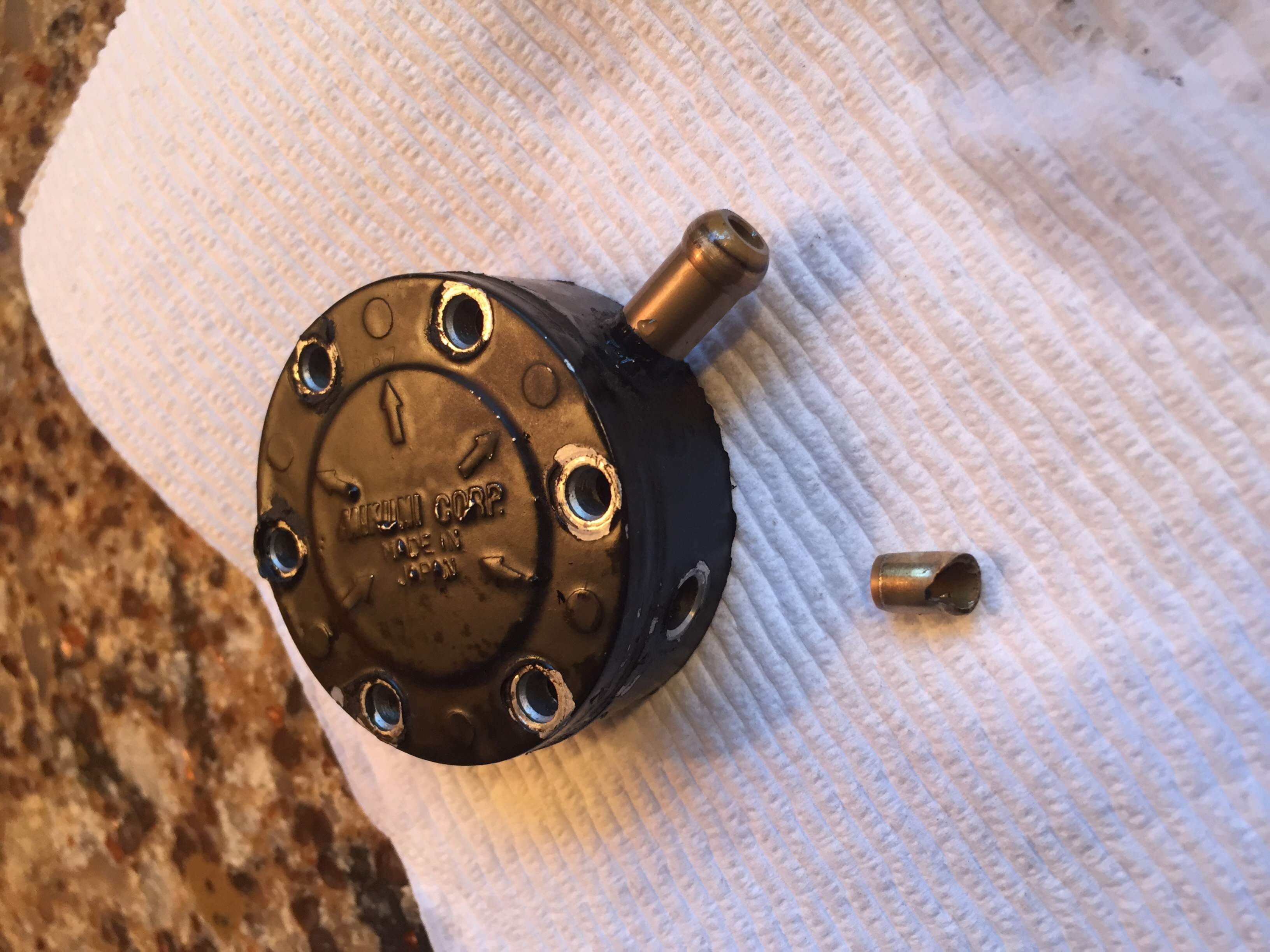

Was just out doing some bush hogging and a stick popped up and snapped off a fuel hose right where it connected to the tractor. I'm going to post a picture of the part. It broke off what looks like a brass nipple where it inserts into a cast aluminum part. I was able to remove the broken end. I am not sure if this "nipple" is something I should be able to buy anywhere or if it's special order or if I have to do the usual jd thing and buy this whole part. If anyone has advice it would be much appreciated. 4300 hst 4x4. image.jpg
I should mention that the broken one looks just like the one that is still sticking out.
/ 4300 parts help #2
What I would do is take the fuel pump apart, then drill & tap the hole for a pipe-thead-to-
hose adapter. You can get the adapter at most hardware stores, usually a 1/8NPT thread.
Otherwise, check JDparts online for a price, and be sitting down when you find it.

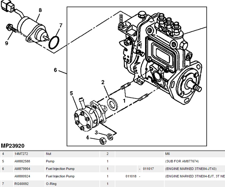

Connected to what part of the tractor??
/ 4300 parts help #4
Connected to what part of the tractor?? Dratted sticks seem to find the soft spots...
Does it look like this "pump" part, item 5 ? If so, about $125
/ 4300 parts help
That's it. #5. $125 doesn't surprise me a bit. I think I'll find a $2 pipe thread to hose barb adapter as dfkrug suggested and tap it. Absolutely idiotic that it wasn't built with threaded adapters to begin with. I am really finding more and more examples where there was a lot of thought put into designs for reasons other than the consumers convenience.
Thanks all.
