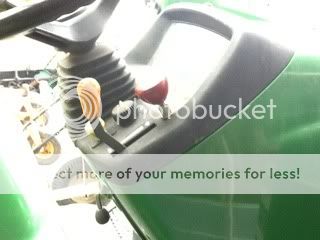

My 4300 ran great all day shut it down . Next morning it turns over wont start JD service comes out tells me I need a new fuel shut off solenoid and puts one on.
runs good for 2 or 3 days then back to turning over but no start. I get on line find this page and start reading about this issue. The thermistor and figure I would try and replace it. Mine was behind the fuse box tucked inside the factory wire loom I had to really look for it you got to take the nuts off the fuse box and take your time to move it around till you can see behind it real tight spot. I got the part from JD for $6 put it on and now I can hear my solenoid make that click sound when I turn the key. I will post a picture of the thermistor after I spliced it in and put the heat wrap on it. My 4300 has been starting like new !!Picture0710151707_1.jpg
