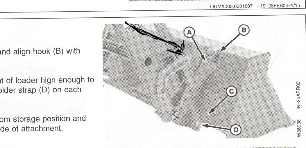

Hi all. I have a 430 loader on my 4300. The linkage that attaches the boom to the bucket seems "loose?" With the bucket unloaded, there seems to be alot of side to side play. In othere words as I am going over bumps, I can see the whole linkage moving side to side. Is this normal or do I have a problem? BTW, the loader is less than 2 months old.

/ 430 Loader - problem?
Hi guys.
Here is the part I am talking about. Seems like excessive side to side clearance to me. I can move the whole hydraulic ram side to side with this linkage. Any thoughts?

/ 430 Loader - problem? #8
Seems as long as pin "C" fits into hole "D" and is secured, then there cannot be much movement side to side of the bucket (as first what I thought you were pointing out).
The side to side movement of the bucket curling hyd ram might be loose for some reason, but I can only move my curling cyl at most about an 1/8" side to side (where your arrow points). You might check the pin size at that connection (the FEL pictured looks like the newer cast linkage, and not the steel plate ones like my 430 FEL on my 4300). The cast iron linkage may be fitted more loose than the older 430 FEL's (how's that for 'poor' grammar /forums/images/graemlins/tongue.gif ).
