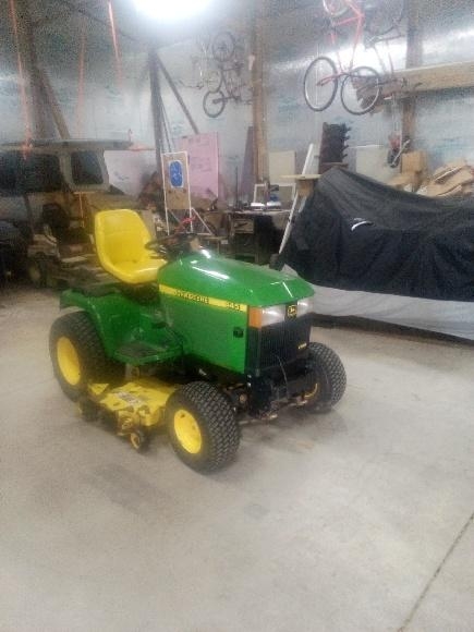

Maybe this is what you want?
I will keep that in mind I don't know how far it is from where I live but I will say I just bought a 1999 445 from a person here locally it has 1000 hrs. Cam, water pump, mower belt and battery all new well taken care of a one owner with all the paper work since Deere did all the work. Here's a pic I apologize my camera doesn't take very good pics.
