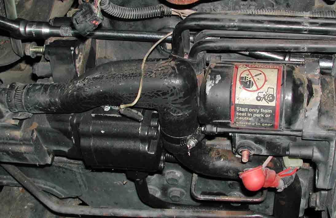

It is indeed part of the implement pump/PS pump, on the left front of the tractor. I would
have initially suspected your inlet screen, but you say you have cleaned it. Also note that
the inlet manifold to this pump is rubber, and can get holes in it.
This photo shows the rubber manifold, with the pump at the left end of it.

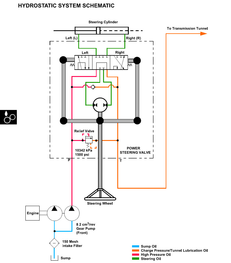

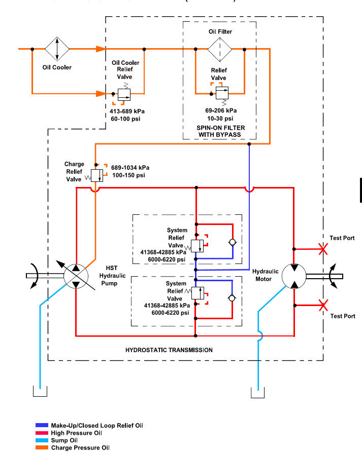

Well the strange part is that all of my implements work just fine and I would expect that they would fail to work too if the charge pump was failing. Keep in mind when the tractor will no longer drive in FWD or Reverse the charge pump pressure reads 50 PSI and yet all the implements work fine. Here are the service manual images:

Can you take a pressure reading of the drive circuit like you are checking the forward or reverse relief valves? Looks like deere installed test ports by the motor for doing this. Curious to see what this pressure does since it should increase to move.
3rd picture shows line for charge pressure connected to the steering unit so suspect return line from steering goes through the oil cooler and then feeds the charge circuit.

The power steering pump shares the same outer housing and main shaft as the implement pump,
but the rotors and seals are not the same. One could fail without the other failing. The PS side of
the pump uses a flow divider to feed the HST charge circuit.
Is the PS weak?

The flow is split in the transmission housing so yes the same pump feeds the power steering and charge system. Did you ever check for pressure in either forward or reverse loop? I.E. the high pressure drive loop. Unless you have the brakes locked or are trying to pull a load a 2,000 or 3,000 PSI gauge would be sufficient for checking to see if you are getting any drive pressure.

Dividing flow between the PS and charge pump happens inside the PS valve, which is on top
of the trans tunnel. The 3 test ports (charge, forward, and reverse) are all accessible inside
the big hole in the trans tunnel underneath, right next to the HST spin-on filter.
Note that the PS runs at only 1500psi, but the HST runs at 6000psi. Other CUTs I have
opened up have HSTs that relieve at 4000-5000psi. I had to get a 10K psi gauge.
