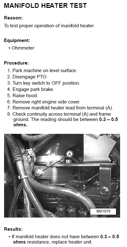

is there a fuel warming unit or air intake heater coil that goes bad on these tractors?
/ 4200 deere cold start #3
The 4200 does have an air intake heater. Wiring would need to be checked, but first you can check the heater itself. This clip is from the 4200 tech manual.

What is leading you to think it is not working?
Do you hold the key in the heat mode a few seconds before starting, and finding it doesn't start?
