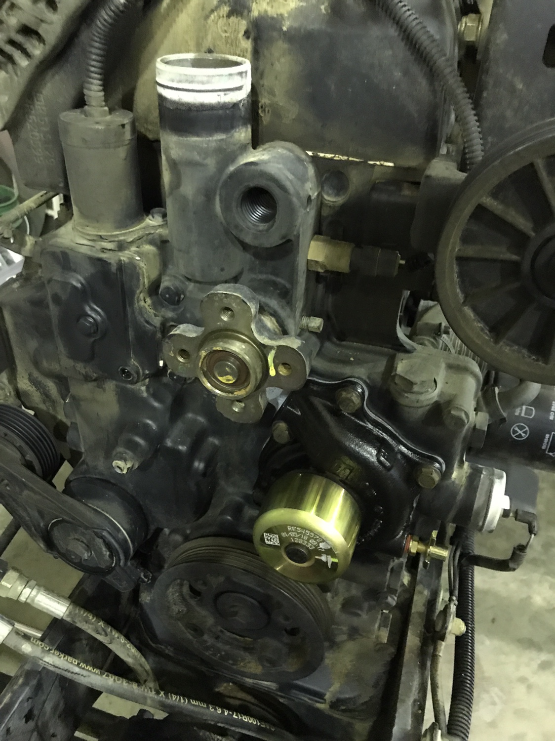

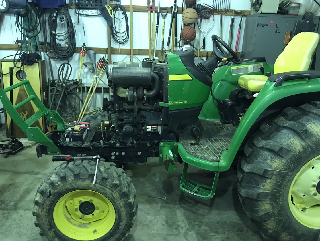

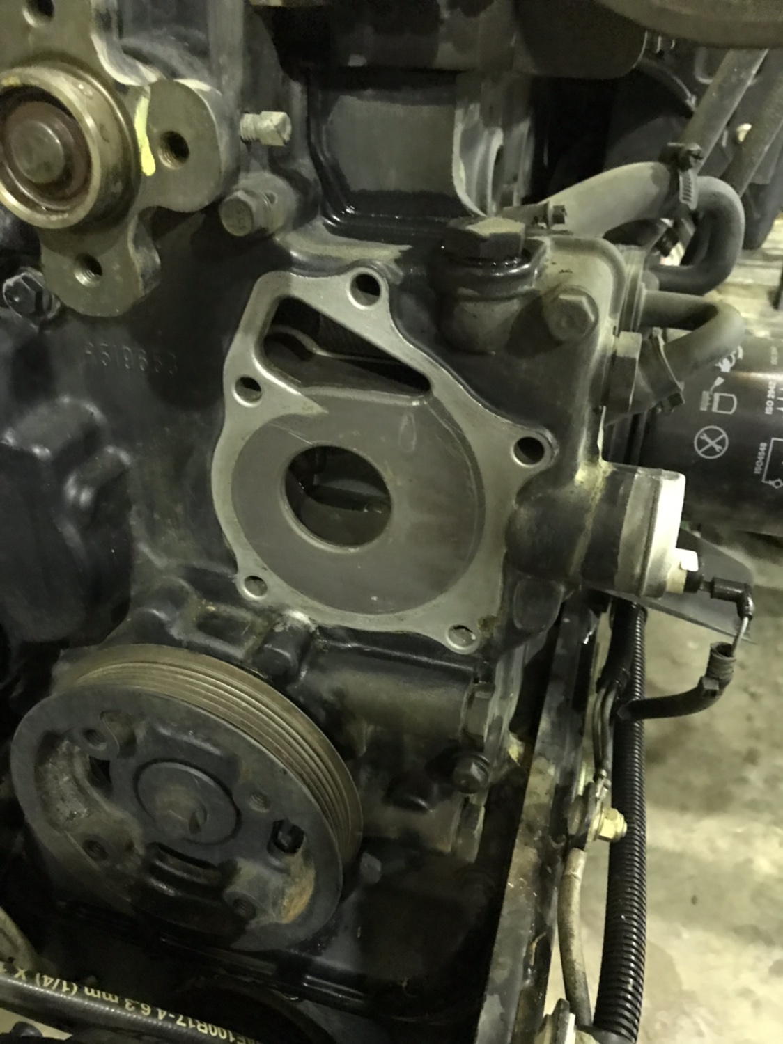

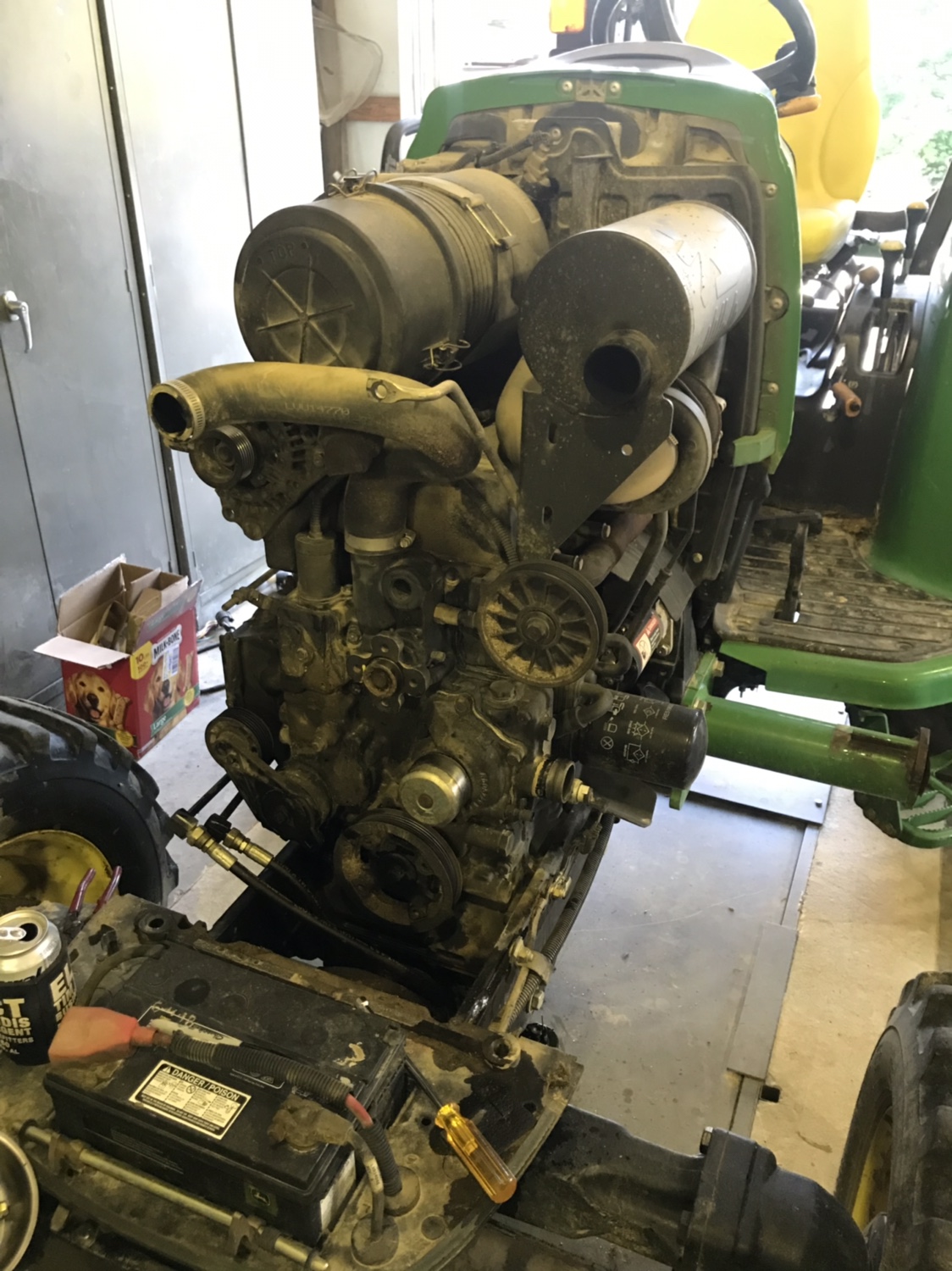

Tried a search on crapa-talk and came up with everything but 4120 water pump. I have to replace mine this weekend as the bearings are shot and started weeping coolant. Any one have a link they could share? 2008 4120 mfwd with power reverser. Open station.

Any torque specs on water pump bolts? I can ask the dealer when I pick up the parts today. Going to go ahead and replace t-stat, belt and radiator cap also.
/ 4120 water pump
So torque specs are 230 in/lbs initial and 230 in/lbs plus 60° turn final.
