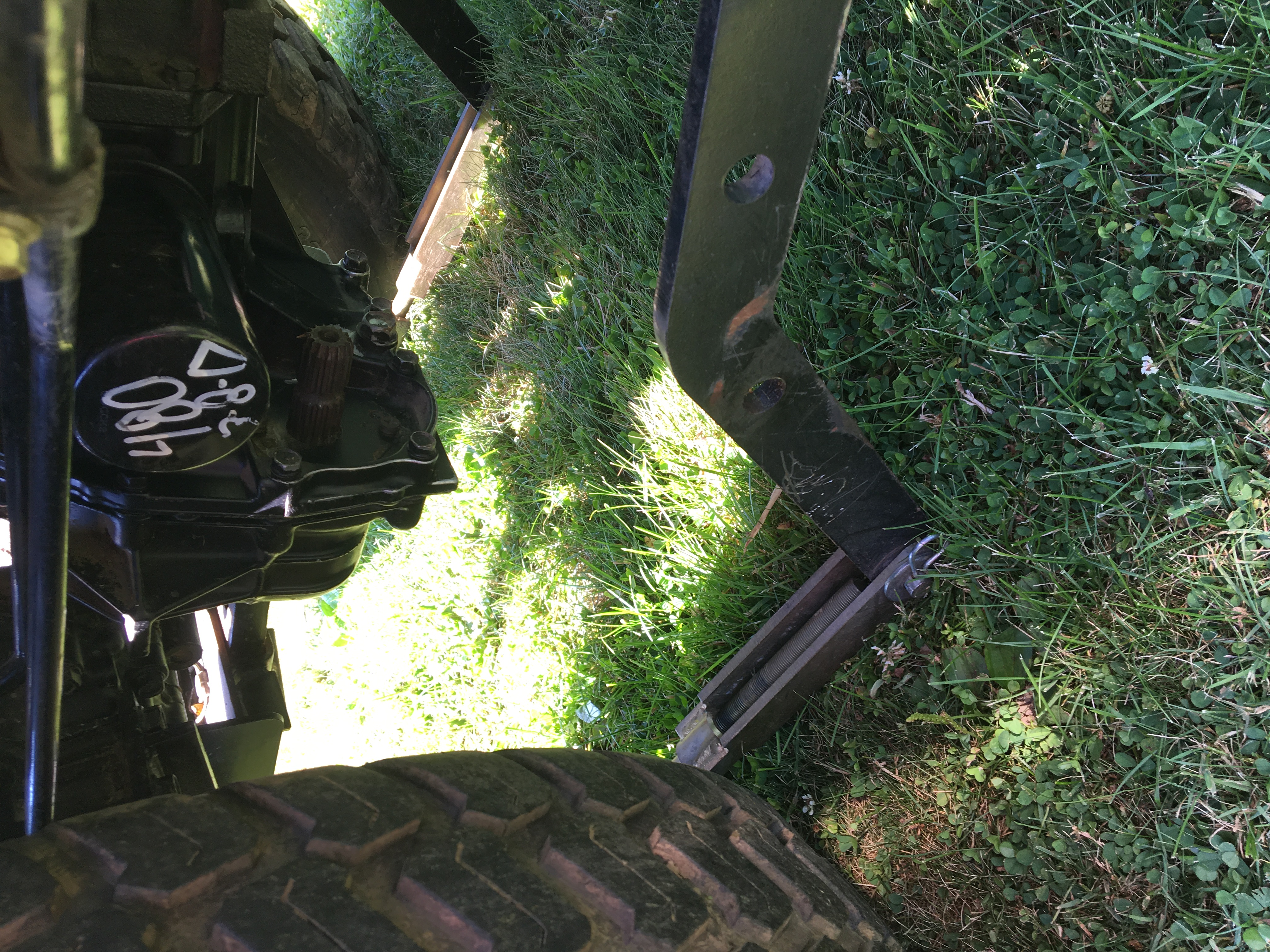

I bought a 4115 with MMM last year. When I take the mower off and lower the the 3 point all the way, the draft arms rest on the ground, which is sometimes a problem when using a back blade or landscape rake.
There is a turnbuckle/clevis that runs from the draft arm to the bracket on the rear. I have tightened that all the way, but the arms still rest on the ground. Has anyone run into this before? Is the clevis just too long? I am fairly certain it's the one that came with the MMM originally.
Thanks for any input.

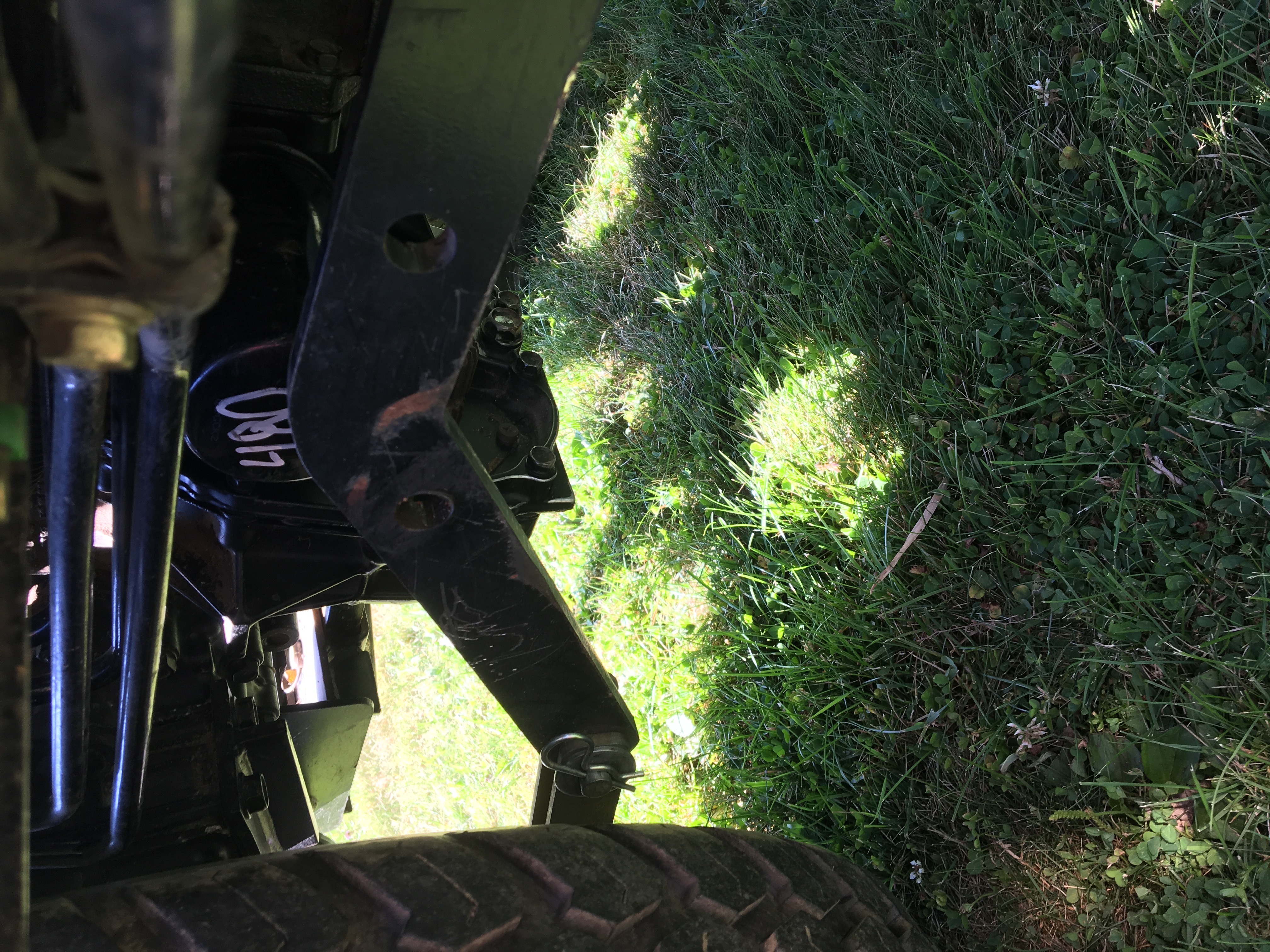

It seems to go up high enough, but I can't really tell if I have more room. I have attached pictures of it up and down.

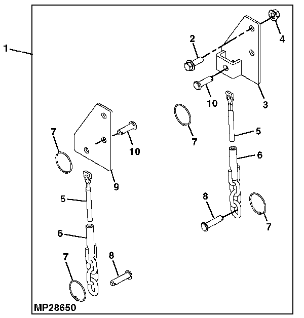

I used the optional "Deck Lockup Kit" to set my mowing height, not really its purpose but doing that meant you could never accidentally mow to low. It would be easy to make these with turnbuckles if you don't have them.
I still think your linkage is setup wrong, it should NEVER go that low.

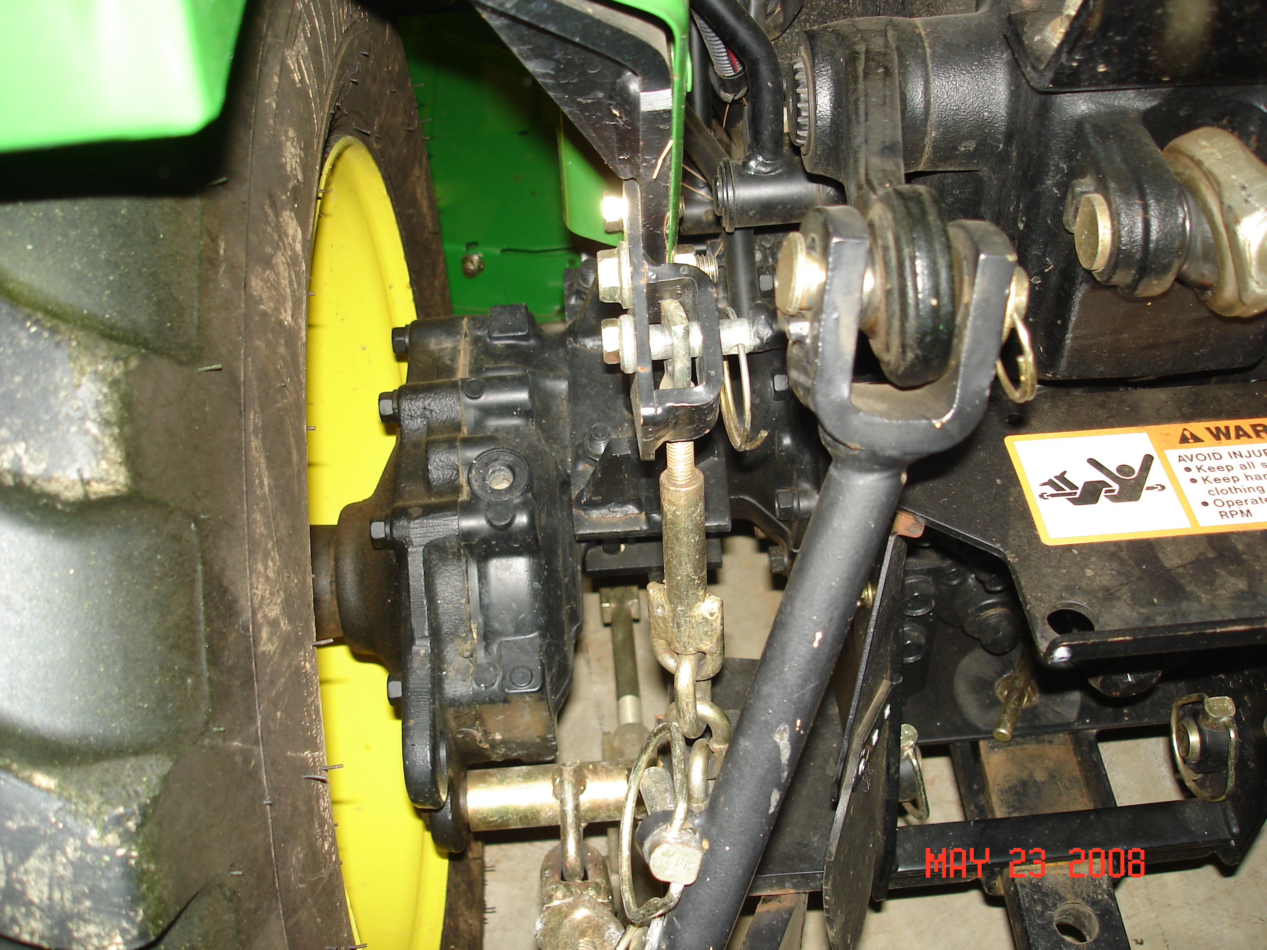

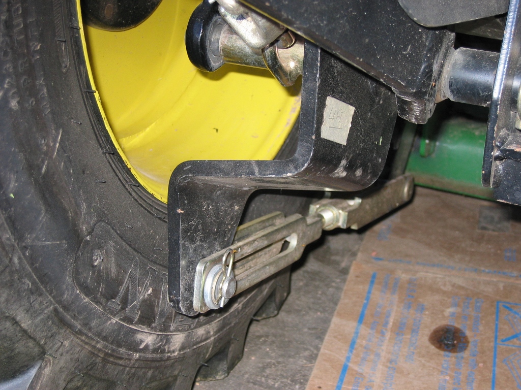

On my 4100 I simply use a couple of turnbuckles to hold the arms up when the mower is off. Turnbuckles also work holding up the arms and the mower when using a 3pt implement.

I have had a JD4100, and two JD4520's with the same lift mechanism. Firstly, those aren't the draft arms, they are the mower lift mechanism. So when folks say that the draft arms should not hit the ground, they are correct, but it's not your draft arms that are touching, it's your mower deck lift mechanism. All of my machines did the same, they have to in order to latch into the drive over deck properly. You have two easy solutions to the problem, either use turnbuckles to hole the mechanism up when the deck is not installed, or you can actually buy a chunk of steel from John Deere that us meant to attach to the hole in the frame above the mechanism bellcranks, and also attach to the clevis built into the bellcranks. Ask a dealer a about his part since I don't have the number handy. It's just a piece of flat iron with a hole on each end. The top end is attached to the frame with a bolt, the bottom end is attached to the bellcranks via a pin through the clevis. You can easily make one of these yourself if you have some simple metal working tools.
