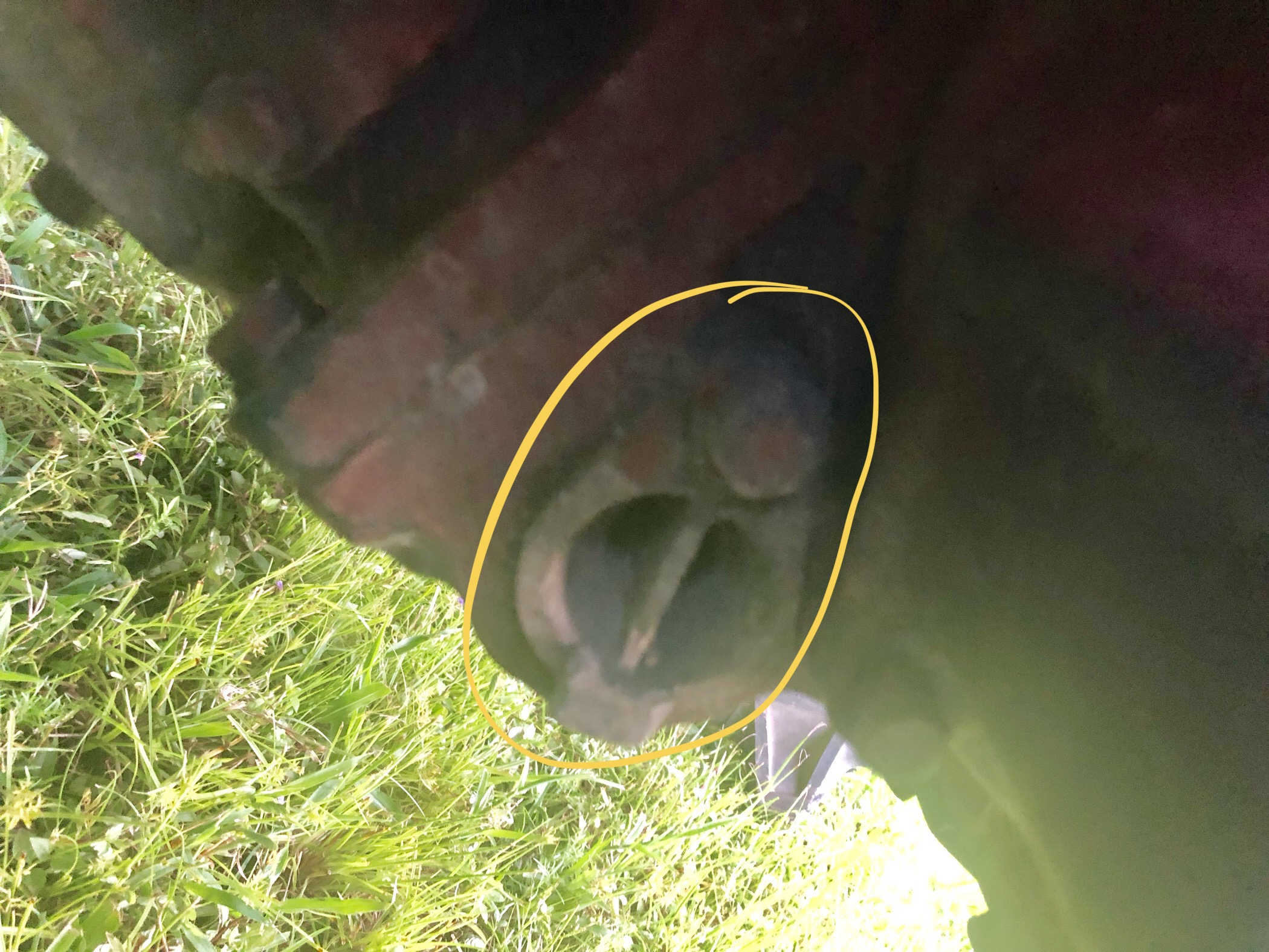

2007 mahindra 4110
Dont know what year it is, it I believe it is an early model. The 3pt lift is slow and I have to throttle up to get it to move. Ive changed the spin on filter by the tire, the large filter screen on the bottom right has been cleaned, and it is still slow. The knob between the legs under the seat has no affect. I was reading about another filter screen on the left??? Is it under this cover plate?
Any help would be appreciated. Thanks.
/ 4110 hydraulic question #2
Linkage, Control valve ,relief valve, Pump. In that order.:thumbsup:
/ 4110 hydraulic question #3
The large canister filter underneath on the right (suction filter) isn't supposed to be cleaned, you replace the cartridge. Then the spin-on filter at the rear left upper side (pressure side filter). Then you have the metal screen filter in the very lower rear trans case (suction side screen), on the left. You remove the 1 bolt holding it in, then twist and pull it out. Of course you better have the hydraulic oil all drained first or you will get a bath. Approx. refill on the hydraulic oil is 8 gallons +/- .
The knob under the seat only controls how fast the 3 pt. lowers, nothing else, although completely closing it will lock the 3 pt from coming down if needed.
