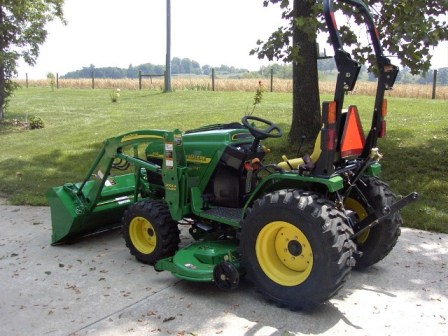

Here is a picture with the 200cx loader. It's very easy to remove and install. I took it off for the first time in just about five minutes, but I should get faster after a couple more times. /forums/images/graemlins/smile.gif
/ 4110 Delivered Today
Sorry about the missing picture. I'll try again.
Here's another
/ 4110 Delivered Today #11
I must say, I just love the color! /forums/images/graemlins/grin.gif
