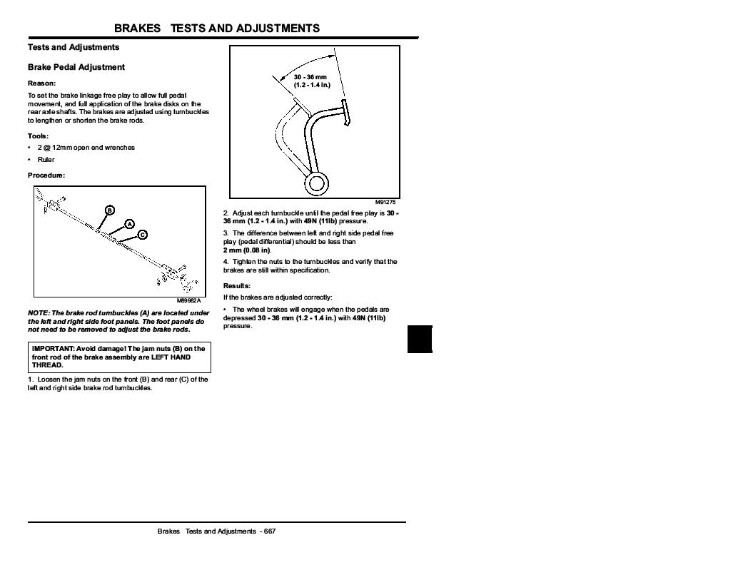

Can anyone tell me if there is an adjustment to set up the brakes on a 4110? The manual doesn't say anything and my pedal is down quite a bit. Thanks.
/ 4110 brakes #2
Here is the page from the FSM. You adjust the two turnbuckles under the tractor.
