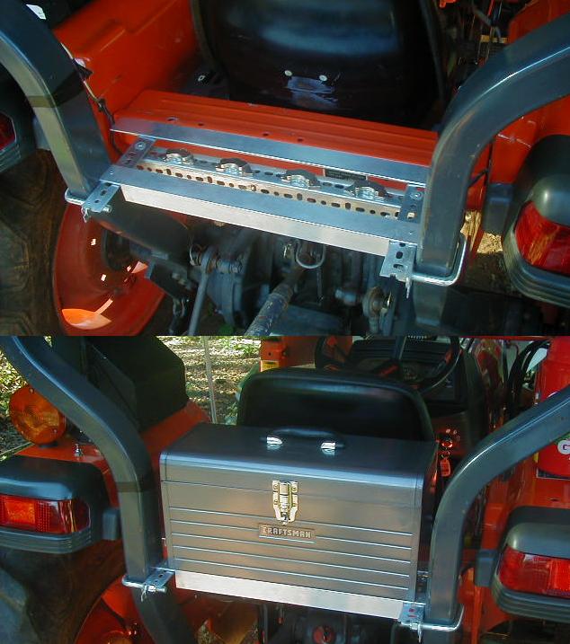

A lot of us have been clamping a rack between the ROPS bars. We're using magnets so the box is easily removeable or replaced with something that suits the occasion. This is a Kubota but it will work with almost any tractor with a ROPS. Also see the thread links the other fellows have provided for complete information and other methods. Hats off to Harv for working me thorough his design. Good luck!

I built a ROPS rack for my 4100, similar to what you see in the other posts. Then I just use a military ammo can for a toolbox, and attach it with a bungie cord to the rack. Works good. I did have to remove my SMV emblem from the rear of the seat to gain eough room. I went to the ammo can, because it is narrow enough not to stick out too far in back of the ROPS. Before trying the ammo can, I used a regular toolbox. It worked fine until I raised an implement to full lift capacity one day. That box went CRUNCH

Thanks all for the references, suggestions and pictures! I admit to feeling as dumb as a sack of hammers for not thinking of clamping a fixture to the ROPS! I'll post pictures the mod as soon as it's complete. -- Chris
