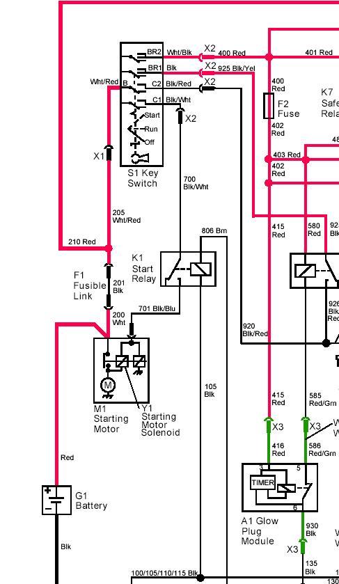

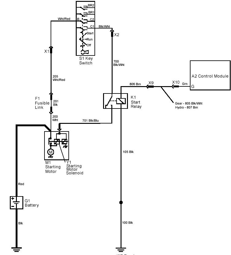

Here is the schematic that shows the switch, starter, and starter solenoid. And the starter circuit with the control module (which may be where the problem lies).

Beenthere, It's after the engine is running the starter does not disengage if the switch is in the start position, which is always the case since it can't be released faster than the engine starts.
Thank you very much for the schematic that's a huge help. The control module may have something to do with the problem.

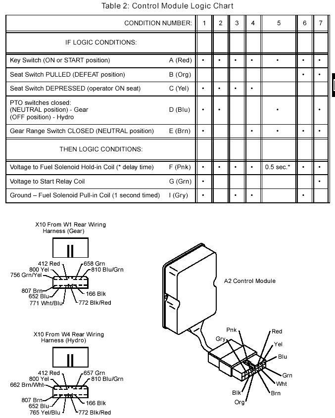

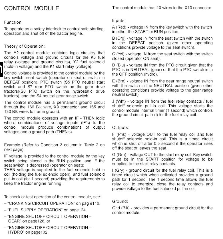

Here is some info on the control module.

I found that the control module is under the left side of the seat.
