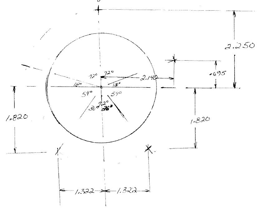

Just an update for anyone interested in putting 4100 R4 wheels on a 855;
It is possible! Or partly I should say.
Ratio:
The rear and front ratio is preserved and there are no problems because the 4100 R4 tires size are exactly the same as what is on JDParts for a 855.
Front Wheels:
For the front, the only problem with the 4100 R4 wheel is the bolt pattern. Going from 4 bolts on the 4100 to 5 bolts on the 855. The good news is that you can mount the tires on the stock turf wheel because the wheels are the same size. Not so in the back.
I wanted to keep both sets so I had a friend machinist drill me the 5 holes. If anyone would like to have the bolt pattern calculation to drill correctly, let me know.
Rear Wheels:
The rear wheels match perfectly and you can switch sides depending if you want the tractor to be 48 or 54 inches wide in the rear just like the stock turf wheels.
I will try to post a picture soon.
One note. Remember that the new wheels use flat lug bolts. The 855 stock wheels use taper lug bolts so best thing is to buy the right lugs from JD. One of the cheap things that JD sells...seriously!

I just sent you a PM. I just picked up a set of front 4100 rims with R4 from the local salvage yard for my 855. Could you shoot me the bolt pattern for the front and how you made the pattern work? I have ag tires and rims so I dont have the option of putting the R4 on turf rims. Thanks

Here it is. I hope the scan is clear enough to read and is helpful for you.
