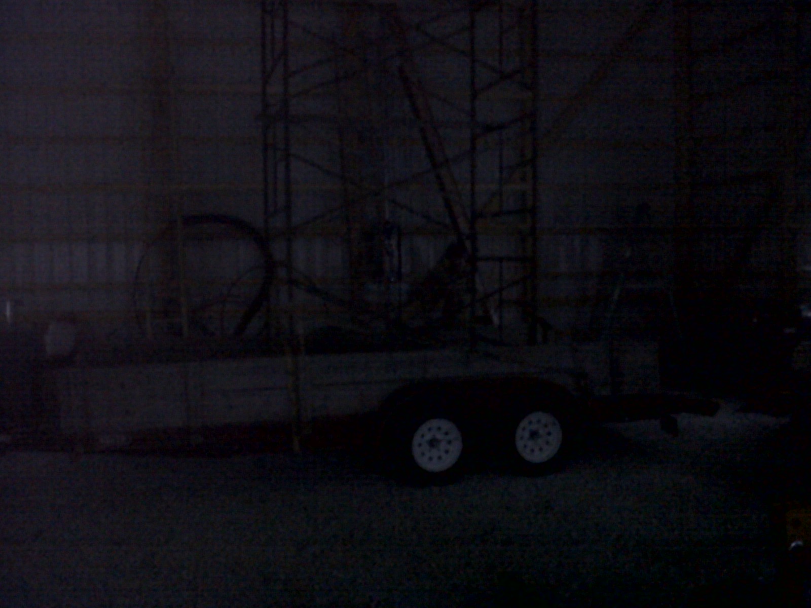

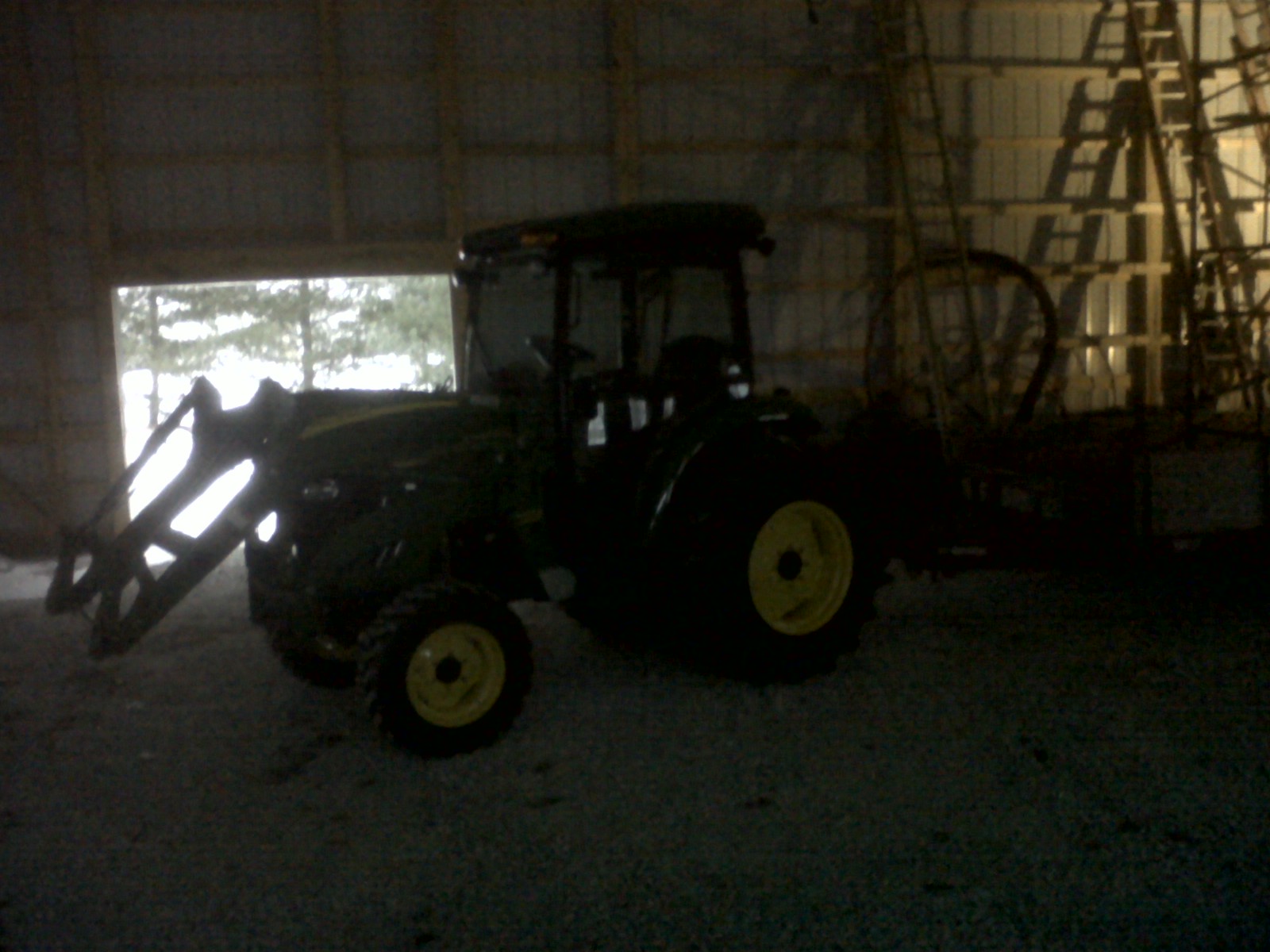

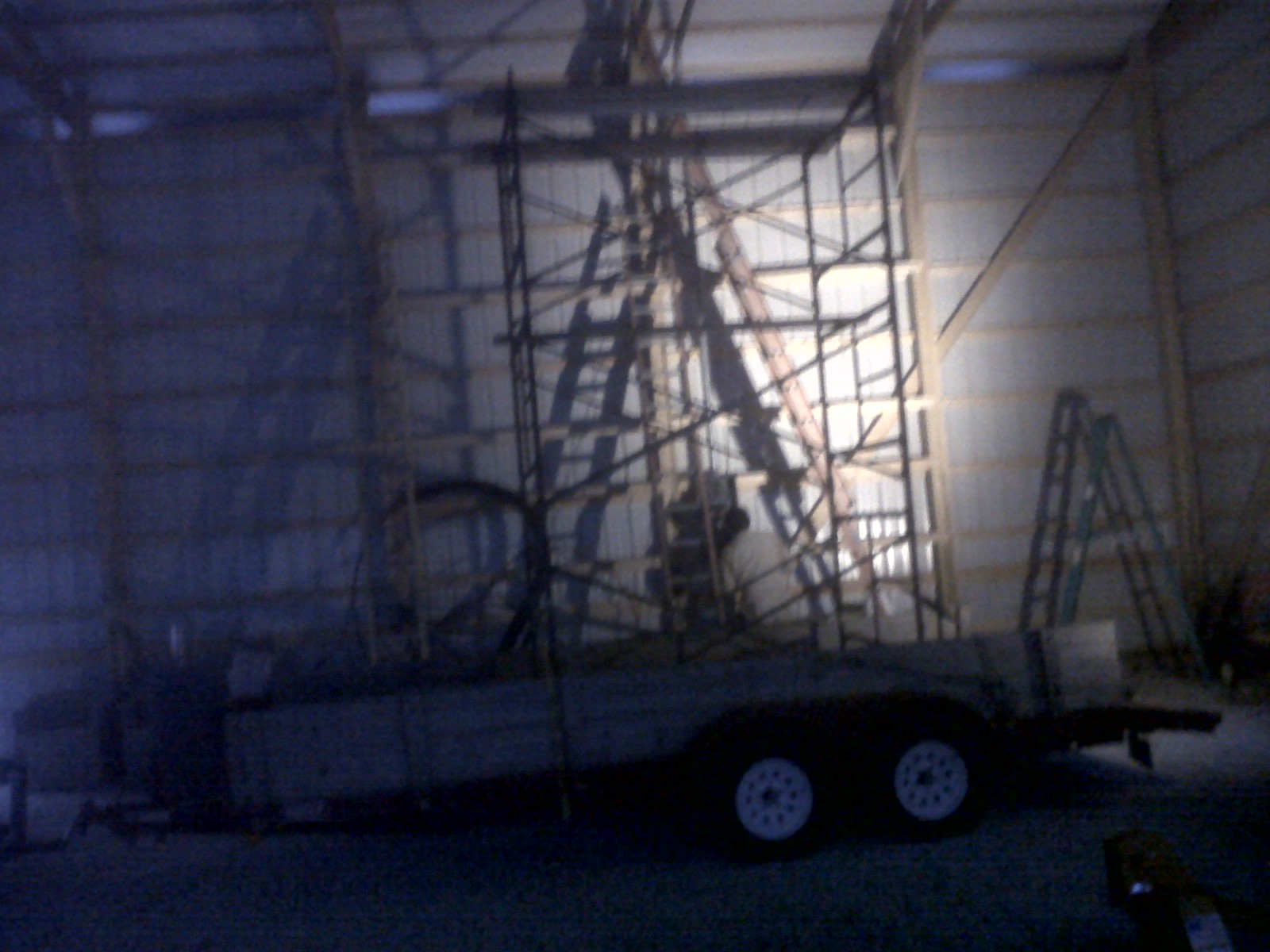

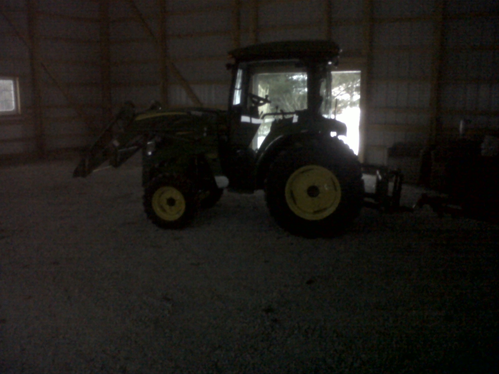

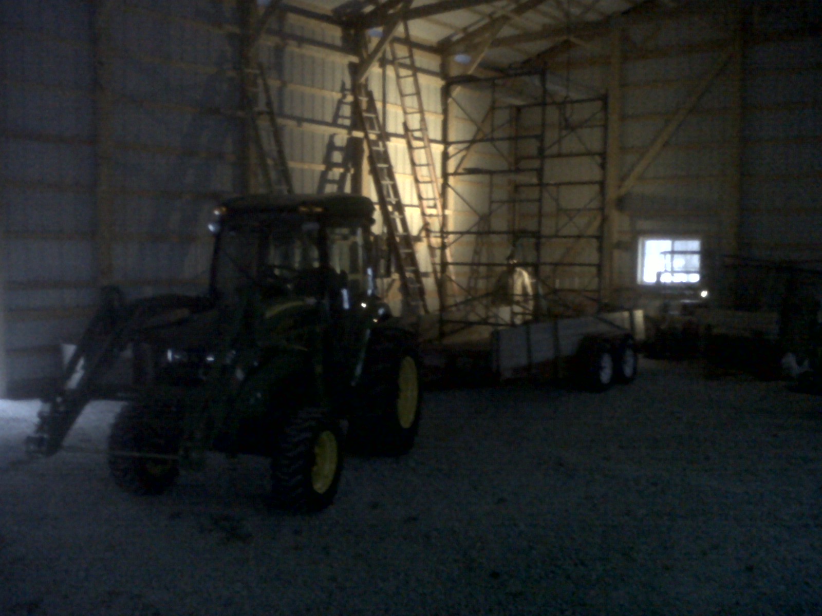

Many of you read my question about installing walk boards across the 8ft span trusses. I have taken your advice and decided against that for now. I am 6'6" 320lbs and there is only about 5 1/2ft for me to walk up there so I am using scaffolding stacked on my smallest trailer hooked to the 4720. So far it is going well. Sorry for the bad cell phone pics. I will get more as we make progress.

Thats actually a pretty good idea. Quick and easy to move. Good luck
